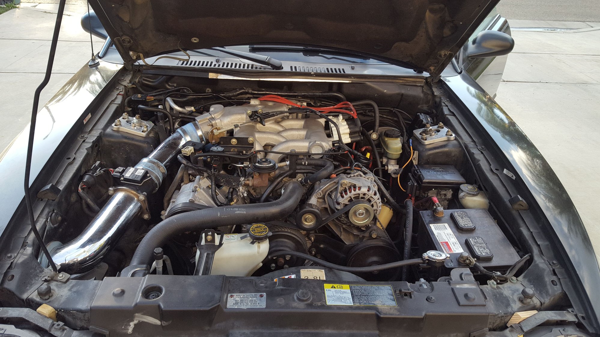

It doesn't look like that.
Here is a picture of it
It has a sticker on the front that says MAC preformace inc, air induction system. I did a search and they have a cold air intake, is that what i have? and if it is, what does it do?
Yea, you just have a different intake. The Stock one is cold air too, you can see
it goes to the fender-well like that one does. The difference is, your air filter is
inside the fender-well. Stock one is inside the engine bay, in that big bulbus
enclosure. Looks like you have an updated coil pack too. You also have camber
and castor adjuster plates on the strut towers, nice.
