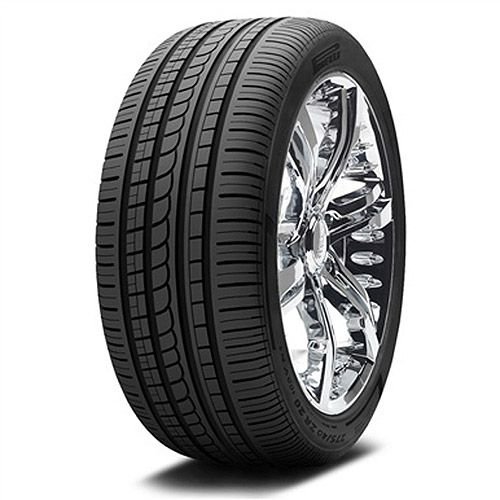

Here's your answer!
255/50R/18 tires on this wheel below which is the best choice for ride.
I'm sure everyone will disagree, but I see no great advantage to a larger wheel size except for looks, & the ride will suffer.

Here's the wheel for you
