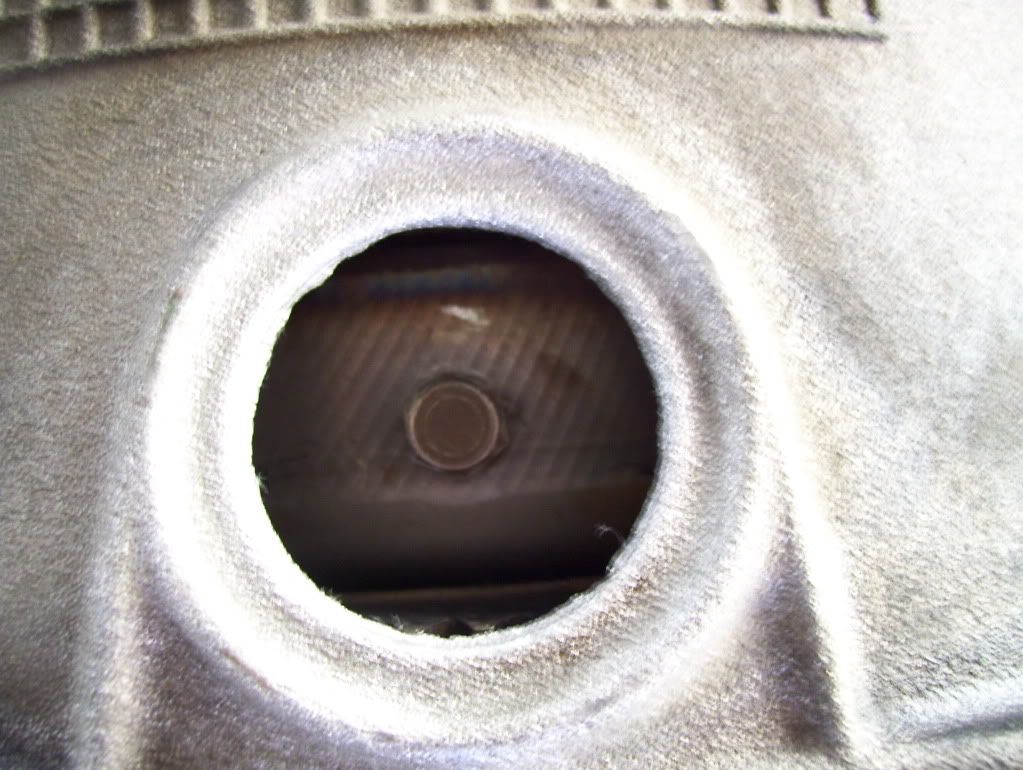

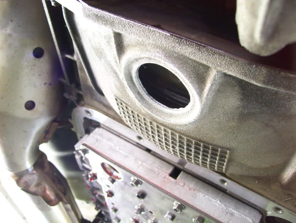

Yes, at that mileage you should flush. Having a helper makes it easier. Find a flat spot to park, use e-brake & chock your wheels. While you have your pan off and are wiping everything down, look to the front of the car. In the housing you will see a circular rubber plug, remove that.

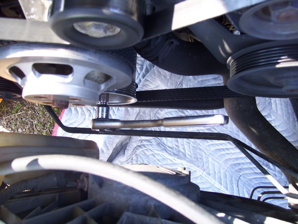

After that, look up in that hole and look for the drain plug. You may get lucky and it will be perfectly lined up, but probably not. Have the helper put the car in neutral. Then get a ratchet and turn your crank slowly.
You are looking for the drain plug to line up with the hole. When it gets there, pop it out and catch the fluid.
Done. Refill and make sure to follow the full service/flush fluid amount recommendations. Be a smart guy and use Amsoil and you will never have to do the job again. Good luck.

Thanks for the gteat pic it will help me a great deal.

Awesome pics mustang99v6.
