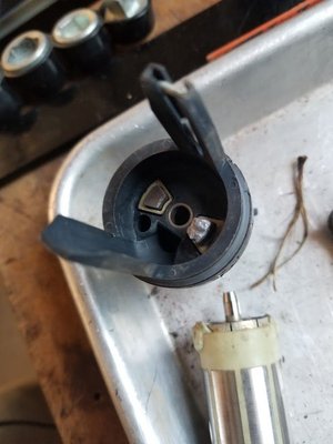

Fuel pump 02 Mustang V6
Dropped the tank and benched tested the pump. I made sure it was dry and blew out as much of the fumes as I could to be as safe as possible. It was definitely bad.
I had a theory that cars that sit a lot, the brushes/armature gets corroded. One that is driven every day from natural ware stays clean. So I had to open it up and take a look.
Never had one apart, so I am not sure what would be normal. The brushes had no spring in them, could be the armature is what moves. Does not make sense to me if that is the case. Hard to tell in the picture, but armature copper is pretty dark. All this is just academical any way, the pump would not spin up.

It's not the brushes or the armature that goes bad, the gears in the pump get corroded from sitting. The gas turns into some syrupy crap and then hardens. You can free it up and use it again, if you have it apart. Sorry to hear about your debacle, hope you get it sorted out.

I applaud your aggressive action looking inside of the motor! Actually, I was under the impression they used brushless permanent magnet motors, and maybe some, many, do. If those brushes EVER got exposed to air, due to very low fuel level, maybe, sparking, guess what?

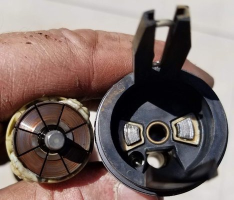

I spent a little more time last night. My understanding is brushless motors did not become popular until the electronics were available to move the magnetic field. I do hope car manufacturers are taking advantage of them (brushless motors) now. Not only the sparking issue but also the issue I had.
Notice in this picture where I un-jammed one of the brushes.
The brushes are kind of messed up since I was trying to use a needle nose to grab it. I used a screwdriver and flipped around and it came unstuck.
After unsticking the other one I put it back together and it actually spun up.
Here is another strange thing, if I am looking at this right, the armature is the impeller. It does not look like the armature drives one. There are no key or slots on the shaft of the armature to drive anything. Also, if you look at the bottom and top you can see the inlet is the bottom and the outlet is the top. So fuel is flowing around the brushes and commutator.
Nothing like I was expecting.
Paid a visit to the local PullAPart, they had on 02 Mustang, that is the good news. The bad news is someone pulled the tank and the filler neck was broke. I did find one, not sure what year it was. Someone had pulled the pumped and it was still hanging by the filer neck. Good news is they left the round holder, so that was holding the weight.
This is a picture of the good end. There is a picture of mine in an earlier post. Now I am really concerned about missing pieces. I don't remember seeing the spring for one thing. At least the tank is empty now so I can really shake it.
