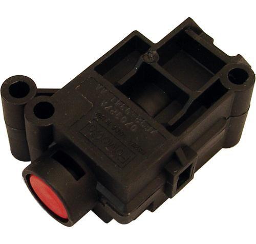

Have you checked the fuel pump shut-off switch? Check the switch in the trunk. It should be on the left side and look something like this. Push the red button to reset it and make sure the harness is connected.
