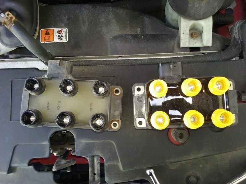

OEM -vs- ACCEL:

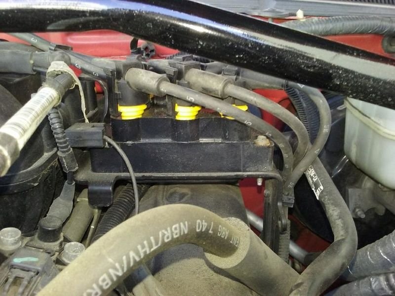

DONE:
I only bought this because I submitted a best offer of $65.00, and they took it. It had the original
one in there, so I just figured on replacing it anyway. Plugs and wires next.

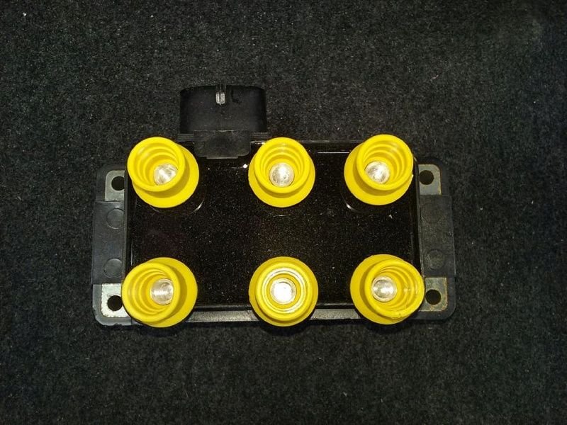

These have 10-15% more spark energy, and lower a rise time. Rise time is imporant
with spark timing advances.
Noticed that these coil packs only have three coils. Two plugs fire at the same time, so
1&5(coil), 6&2(coil), 4&3(coil). The only difference in the coil pack itself, is, for some
reason 1&5 is spaced slightly farther away from 6&2. Look at the tops of both coil packs,
see that the OEM they're spaced evenly, and the Accel, 1&5 has a slightly larger
cap from 2&6. The harness is four leads, power, Coils 1-3, and the ground is under
a mounting bolt.
