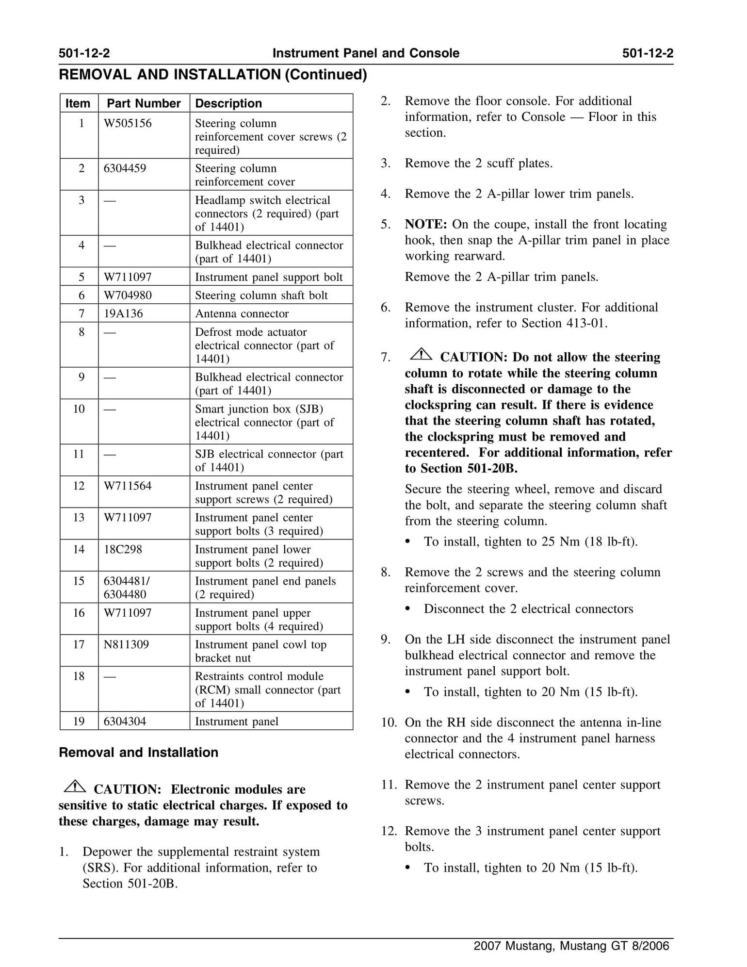

Old Aug 15, 2019 | 04:49 PM
areebashar.23's Avatar
areebashar.23
Joined: Jun 2019
Posts: 35
From: Alberta
Actually I found the diagram for ya.
