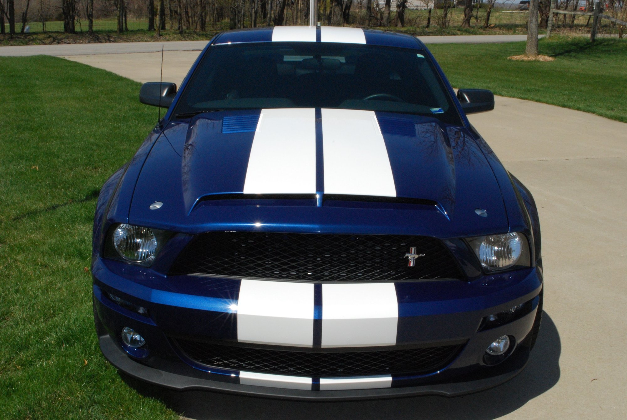

I changed hoods because I converted my stock GT front end to a GT500 one, and then added a trufiber hood to finish it off. From my experience, I need my hood pins and wouldnt run without them. The hood I bought thru trufiber (2007-2009 Mustang GT500 Fiberglass A53KR Ram Air Hood) has circle holes for my hood pins anyway, so if I didnt install them it would have looked stupid. Still, I know firsthand that when I'm out on the highway running 70 or higher, I can see my hood 'float' if I dont have the pins tight. Not that it will come loose and flip open, but when I've driven it at highway speeds with them unintentionally loose, I can absolutely tell a difference how the hood reacts verses when they are clipped in (and yes, thats with adjustments to the black 'spacer' deals in the engine compartment that the hood rests on) that keep the hood tight to the car. When I'm just running around town, if I don't have them latched, its no big deal at all.
If you have already got your hood or are still considering it, be forewarned that if you have or plan to switch over to shocks to hold your hood up when doing something (engine work, detailing engine, car show, etc), you cant run the typical hood shocks. If you do, when your hood is closed, it will bulge where the shocks connect to the hood and eventually will damage the hood. And just like before, it will be the same circumstances when getting it painted and installed, just like the stock hood....prep is key. I'd make sure you have 100% faith in the painter and their quality of work. I'm all about saving money where possible, but I never hesitated to go to whom I considered the best at the time to do the paint work despite their prices verses others, and have zero regrets this much later. Quality of work speaks volumes, especially over time.
Despite having my Trufiber one painted and installed now for close to 10 or more years. The hood still looks phenomenal on the car and I couldnt be any happier. That being said, even now, 13 years after buying my mustang (I still only have around 28k on the odometer), mine is always garaged and never sees snow or rain other then when I open the garage door and it blows some on it. I have no idea how a fiberglass hood would stand up to 24/7 outside and exposed to the weather.
