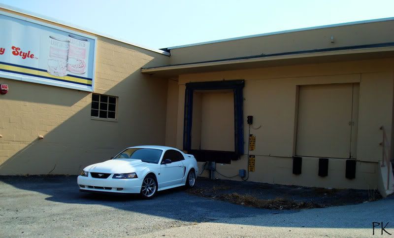

i have 2 in the front and 1.6 in the rear no C/C plates but i do have steeda X2 balljoints for the front which lower it that extra.5 in.

u have ne side shots of that? i wanna lower mine but i dont know if i want an even drop or more up front

Hah.. OT but nice car.
Old Mar 24, 2008 | 09:45 PM
MustangMan00's Avatar
MustangMan00
Joined: Mar 2006
Posts: 2,374
From: MD, but NC for school
Default RE: lowering question?
heres some most recent pics and a side view shot
Old Mar 24, 2008 | 09:49 PM
MustangMan00
Joined: Mar 2006
Posts: 2,374
regular eibach pro kit.....before i did the ball joints and took out the rear isolators
