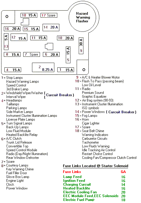

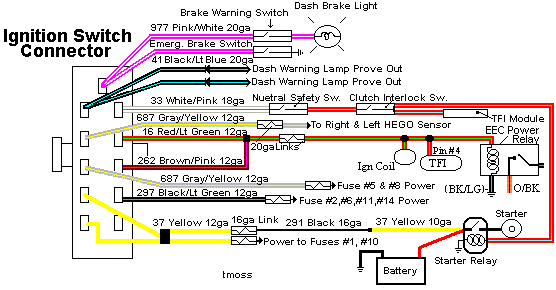

If this is on a Foxbody,remove the temp gauge wire from the temp sender,turn the key on/engine off,touch the wire terminal under the rubber boot directly to a bare spot on the block.The gauge needle should peg to the top.If it does,the gauge and wire are good,but the sender is bad.If this test fails,connect the red lead of a multimeter to the sender wire and connect the black lead to the sender wire at the back of the gauge cluster,with the wire disconnected from the cluster.The meter should read 2.0 ohms or less.If not,the wire is open.If the wire is ok,the gauge is bad or theres a cluster issue.If you suspect the bulbs being blown, it wouldn't hurt to pull the cluster and check.Youll have to do that anyway,in order to test the sender wire.The temp gauge sender is located at the driver side front of the intake.The ect sensor only affects the ECU.Its located in the metal heater hose pipe assembly that runs over the lower intake (passenger side) Check fuses #4,13 & 18 for the cluster lights & warning lamps.Check the fusible link near the starter solenoid for fuse #4 also.The diagrams at the bottom will help with the cluster lamps. Regardless of which warning lamp it is,each one of them should illuminate briefly as soon as you turn the key on.If a particular lamp fails to come on during this time,its bulb is blown or theres a possible wiring issue or other fault present.A fault within the ignition switch can also fail to cause the proveout lamps to come on.The ignition switch diagram id's whether or not the lamps you're lacking are part of the ignition switch circuit or not.You don't need a scanner in order to read codes on the 86-95 models.Get a paperclip or jumper wire and follow the instructions in the following link.Post any codes you get.
