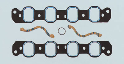

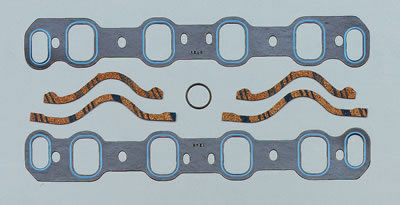

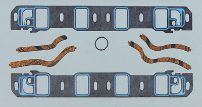

Cleveland 2V
Cleveland 4V
Windsor
These should help out a bit...

ORIGINAL: Bentworker
Cleveland 2V
Cleveland 4V
Windsor
These pics dont show the ENORMOUS size difference between the 2V and 4V, and how much larger the 2V is than the Windsor. The 2V gaskets outer edge around the ports will fit inside the 4Vs ports.. its not a small difference.. Using a Windsor intake would be like feeding air into a sewer pipe from a garden hose. Additionaly the difference in deck height means the intakes are different widths, and the bolt holes are not the same. To do it right it takes a dedicated intake, and if you are going to all the trouble then you want to do it right.
