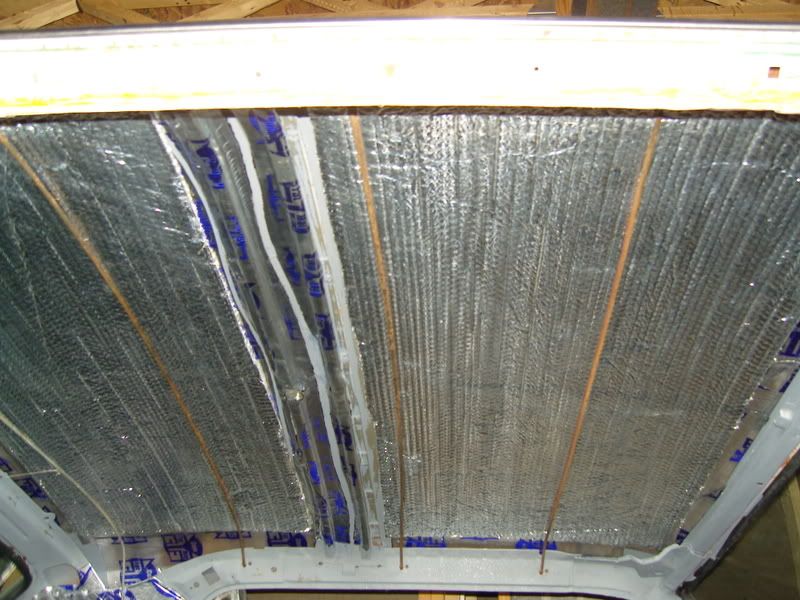

I did 100sqft of Fatmat, and it came with a handy little roller and knife, for about 80$ shipped. Then I adhered Tekfoil to the roof and firewall to greatly reduce heat. It's the same as that shiny stuff old people put under their windshield to keep the sun out.
Alltogether I spent about 100$ and only added around 30lb. Tekfoil is near weightless.

Here Hot70, I posted pictures of my progress back in January. They seem to be usefull in showing how much you can actually cover with 50sqft and 100sqft. I don't believe they show the Tekfoil, I'll have to find separate pictures of them....

thanks i found this very helpful. how air tight does the foil have to be? it looks very taught over the floor. was this very hard to achieve such a tight fit or is it somewhat average skill level to put in.

It came with a little wooden roller that flattens it all out. The more I worked with it the quicker and better I got at laying it down smooth..
If your doing the floor, its not that important to have it all flat and stuff, but if you do vertical or completly upside down, you HAVE to roll it nice and flat. Actually, I'd highly suggest using a heat gun when doing vertical or upside down. It makes it extra sticky...
