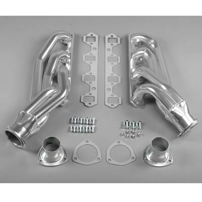

well, I got my Patriot H8433s today but there is a problem. The headers I received are not H8433s. The right side (passanger side) header does not fit. Instead of dropping the collector down it puts it right into the firewall.
Old Feb 5, 2009 | 04:39 PM
fakesnakes's Avatar
fakesnakes
Joined: Sep 2008
Posts: 1,839
From: Connecticut
The right one looks like the wrong one. Here is a picture of the correct one:
It looks like they packed the wrong one!

I found them on the summit website. Apperantly these are H8430s which is a discontinued part and superceded by H8433s. According to the summit application chart they should fit.
http://store.summitracing.com/partde...0&autoview=sku
