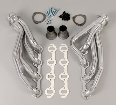

JBA 1650SJS - ceramic coated stainless steel mid length. Don't know why they wouldn't fit the Modern Driveline cable clutch since they do fit with the Mustang Steve cable. When headers interfer with the cable, it is at the bellhousing. With short/mid-length headers, you can route the exhaust away from the cable.

Got the Hedman 88300's today and they definately do not work. The fit is fine but #7 tube is directly in front of the hole for the cable. Really don't want to spend 5-6 hundred so I guess I'll have to settle for some shortys. Keep in mind I am using a 351 not a 302. So if the 88660 did not hit the valve cover, so far they are the only one's that do clear the cable! Any suggestions for one's that will work for me? Thanks

I bought the Heddman 88656 and they are a perfect fit!
Here they are in the car:
