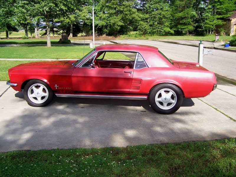

Don't know if you are interested in this style rim, but I used 4 lug wheel adapters to convert my 67 to 4x4.25 bolt pattern. I ran fox body pony rims on it. Here is a picture.
