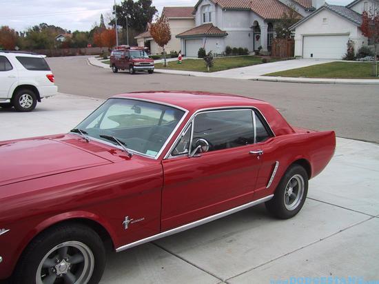

These are the 215/60-15's on 7" Magnum 500's with 4.25 backspacing I used to have on my 65. Never had any tire rub issues
In the sig pic below this is 215/55-16's on 7" rims.

I would run 215 60 15s. That is the perfect size for 65-66.
I have 215 60 15 on the front of my 65 with 15x7 Magnum 500 and 4.25 backspacing. I have no rubbing issues and have 1 inch lowering springs on the front. I'm actually considering going to the same size in the rear. It currently has 235 60 rear.
