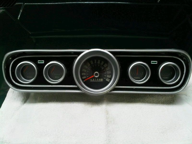

well, got my cluster back. look's grate he did a really grate job!
wired up everything and guess what. the oil gauge go's all the way the H and wont come back down even if the motor die's only if you turn off the key,
for some resion the hole cluster has power going throught it????
my fuel gauge is reading way wrong and my courtesy lights dont work. (no power) and my motor still wont turn off with the key. i fallowed the book to the T and im having more problems then a *&#%$@#%#(#&@#(*&@&% chevy.

Old Nov 15, 2010 | 09:13 PM
  #44
broncomitch,'s Avatar
broncomitch,
Joined: Oct 2010
Posts: 68
From: utah
before
after
his work.

Send the Painless wiring back and get reproduction wiring.
The instrument cluster looks nice. I suggest getting an electronic regulator for it.

The cluster certainly does look nice. And I'll never use a "painless" kit, mainly because I can't afford it.

OK on a more serious and thread-related note, that cluster does look great. I would like to know his techniques. Yes what he does is spelled out, but how he does them, I didn't catch that part.....

on a more happyer note. i drove it around last night and got my gauge light's working. (light switch is broken) but ran a jumper wire so now it work's.
also, im running
it was nice to drive but i really need power steering. it's not fun lol
also, there is a voltage regulator on it. tho above it is a spade term im guessing for a ground? that's not hooked up cus it say's nothing about it on the book, tho there are two wires left over from the cluster wiring section i have now idea where they go too.

and is my voltage reg bad? seem's like a lot of power is going through the gauge's. i checked the fuel gauge with the key on and it was 55.1
