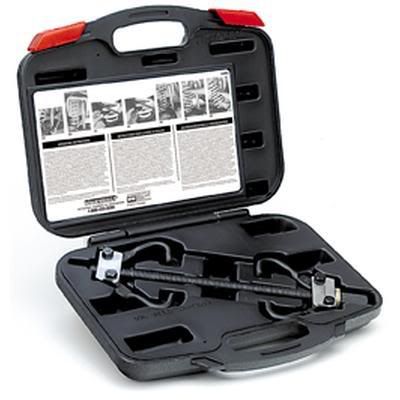

If you do decide to remove the spring use an inner spring compressor like this which you can also rent for free:
