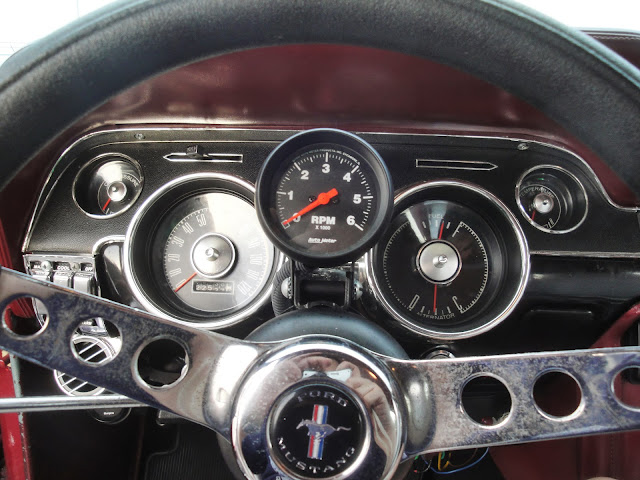

I should mention I have two temp gauges
The center one is coming from a port right at the thermostatand will creep up to 210ish (maybe go over) without the AC on highway driving (I have a switch so it can read the trans or the coolant)
The normal gauge which come off the manifold closer to the carb will end up 75-80% to the hot side which is why I am concerned it is running warm but not overheating.
I am concerned in 95 degree weather it will be worse and forget about flipping the AC switch.
