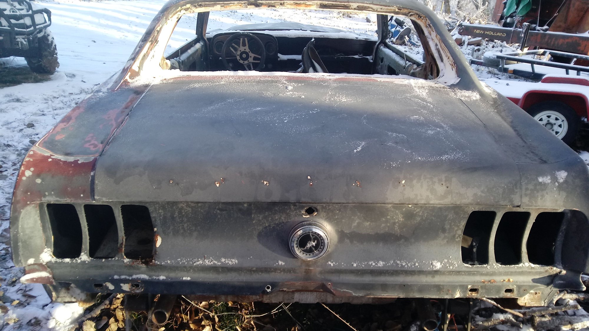

Hi, I recently acquired a 1969 Mustang Notchback(Automatic Transmission), and I've got every piece I need for a restoration project. The whole thing has been gut, and I plan on putting it all together, but Im not sure where to start. Im going to clean it all out and get it looking nice, but should I put the V8 in first? Or should I put what I can in before installing the engine? Ive heard it both ways before, so if anyone could confirm which way is best, please do, it'd be a great help.
Pics of the project below You can see that it just has some worn down primer around the edges(Still considering what kind of paint to do. Im thinking a nice cherry red with matte black, or a cherry red with double white racing stripes. I like red, but any color except green and pink will be considered)
The only rust damage is on that left tail light, but I believe I have the parts to replace that, you can also see a crack in the gas cap(The fuel tank and the exhaust pipes seem like they are still pretty solid, Ill do some cleaning though)

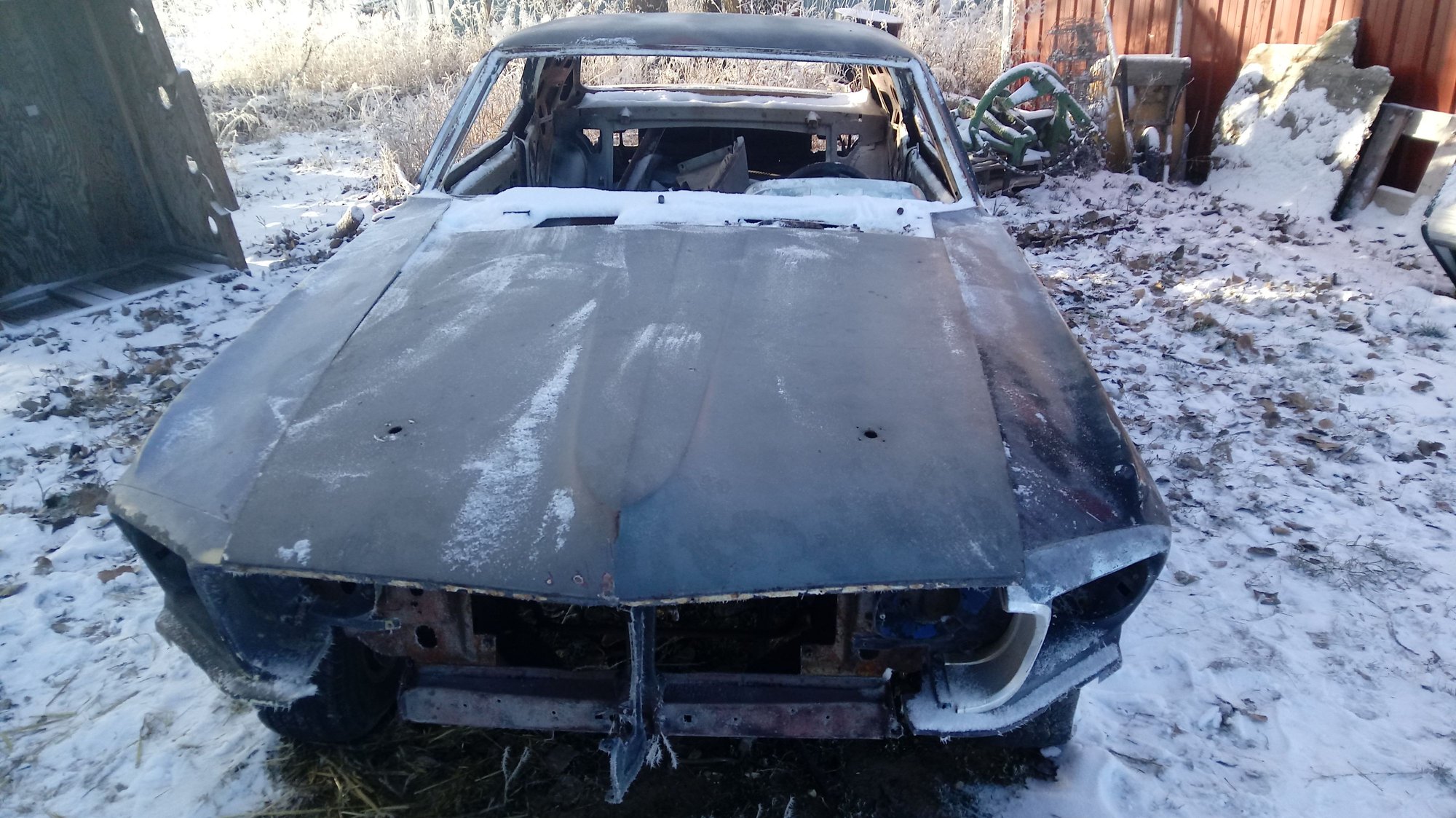

The hood has some holes in it for some reason... A few people are guessing that its a race mod, and that there were originally some pillars you put pins through to hold the hood down so it doesnt blow off while racing, but if anyone is more knowledgable on the matter, I'd appreciate some enlightenment in this area too.
