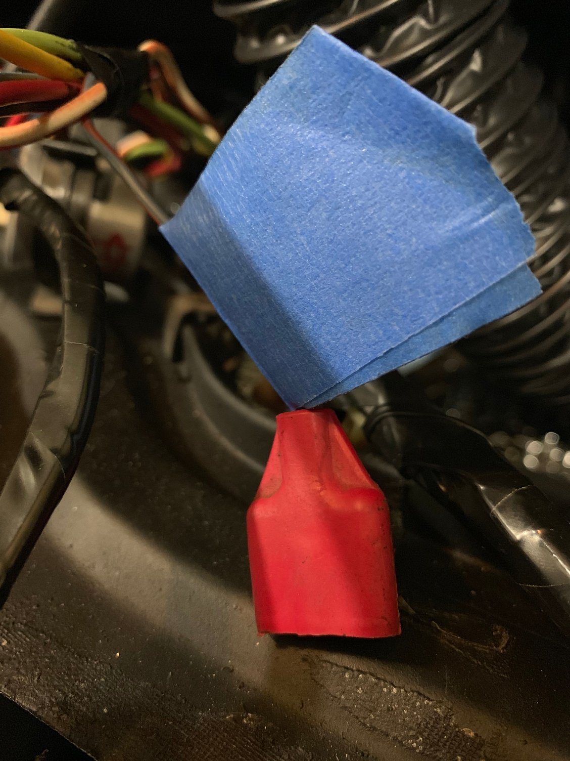

It has been awhile since I pulled my under dash harness and now I'm reinstalling it. I lost my photos and notes when my laptop crashed and was hoping someone here can help me out. Can anyone tell me what these two connectors go to? I am installing photos of the connectors but in case they don't come up one is a green two prong female plug that is over the glove box and the other is a red 3 prong female plug that comes out close to the radio. Any help with this would be great.

I seem to remember the red female x3 plug on my fastback. If I recall, it wasn't used for anything and was constantly hot so I used it to run to my overhead console light switches and the other two were left unused.
The green one I don't know. In any case use a test light and see when or if they are hot and use them accordingly.

Thanks for the input. I talked to a guy who is familiar with Mustang wiring harnesses and I found out the same thing about the red plug. I was told that the green plug is for the clock and or other dash lighting and won't be used on my car either since I don't have a clock in the dash. I guess I should've come back on here and let everyone know that I found the answer to my question but I forgot. Thanks again.
