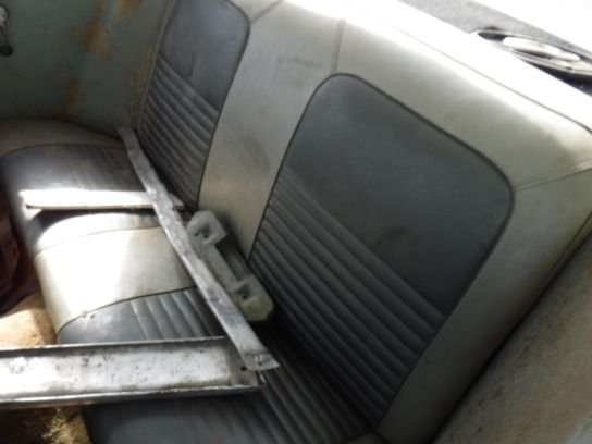

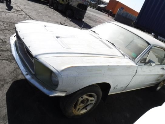

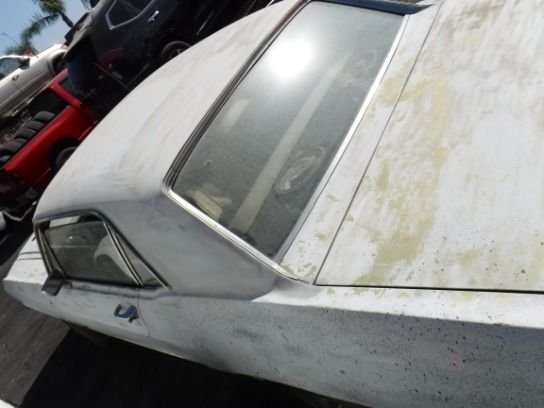

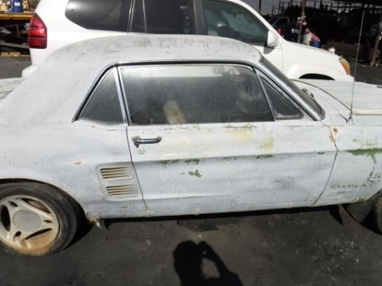

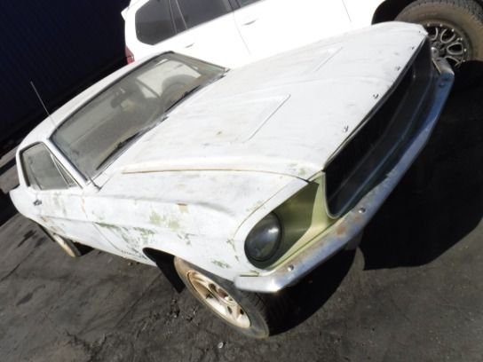

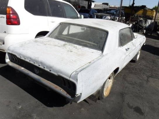

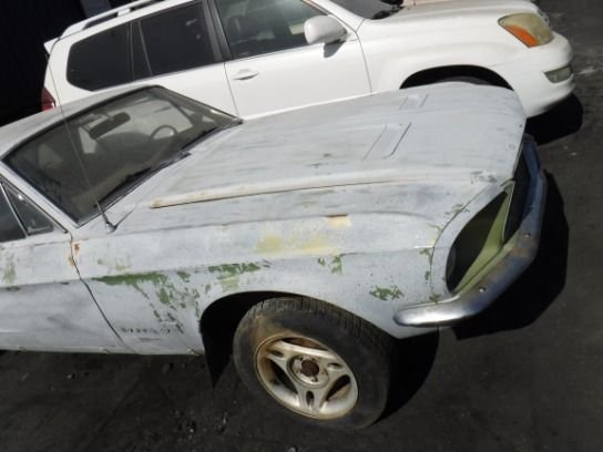

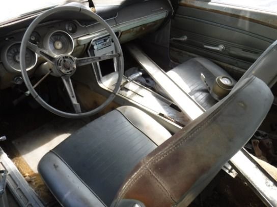

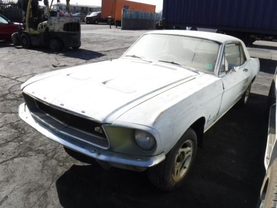

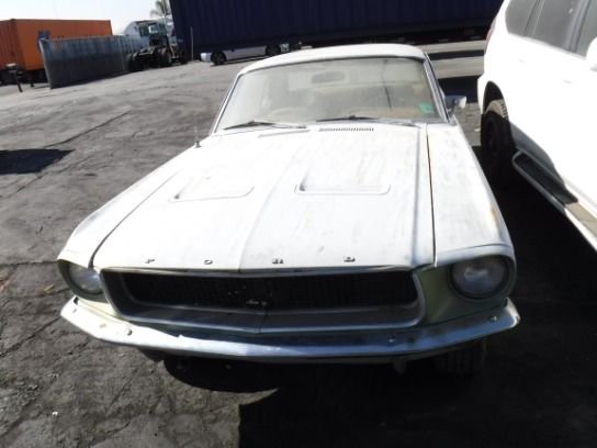

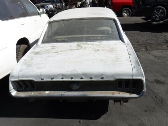

So a dream came true ( still in the making) when I bought a 67 coupe with the intentions to convert it into an Eleanor.
With very basic to no knowledge about classic cars and Mustangs I am relying on expert opinions. I don't know what I've signed up for as I've not inspected the car and relying on the information provided by seller and photos shared by the shipping company. so far what I know about the car is .
1. Original 67, 8 Cyl. 289 CID, 2 barrel carburetor
2. It has no engine only transmission
Below are some of the pictures that I currently have.
This is what I want to build.

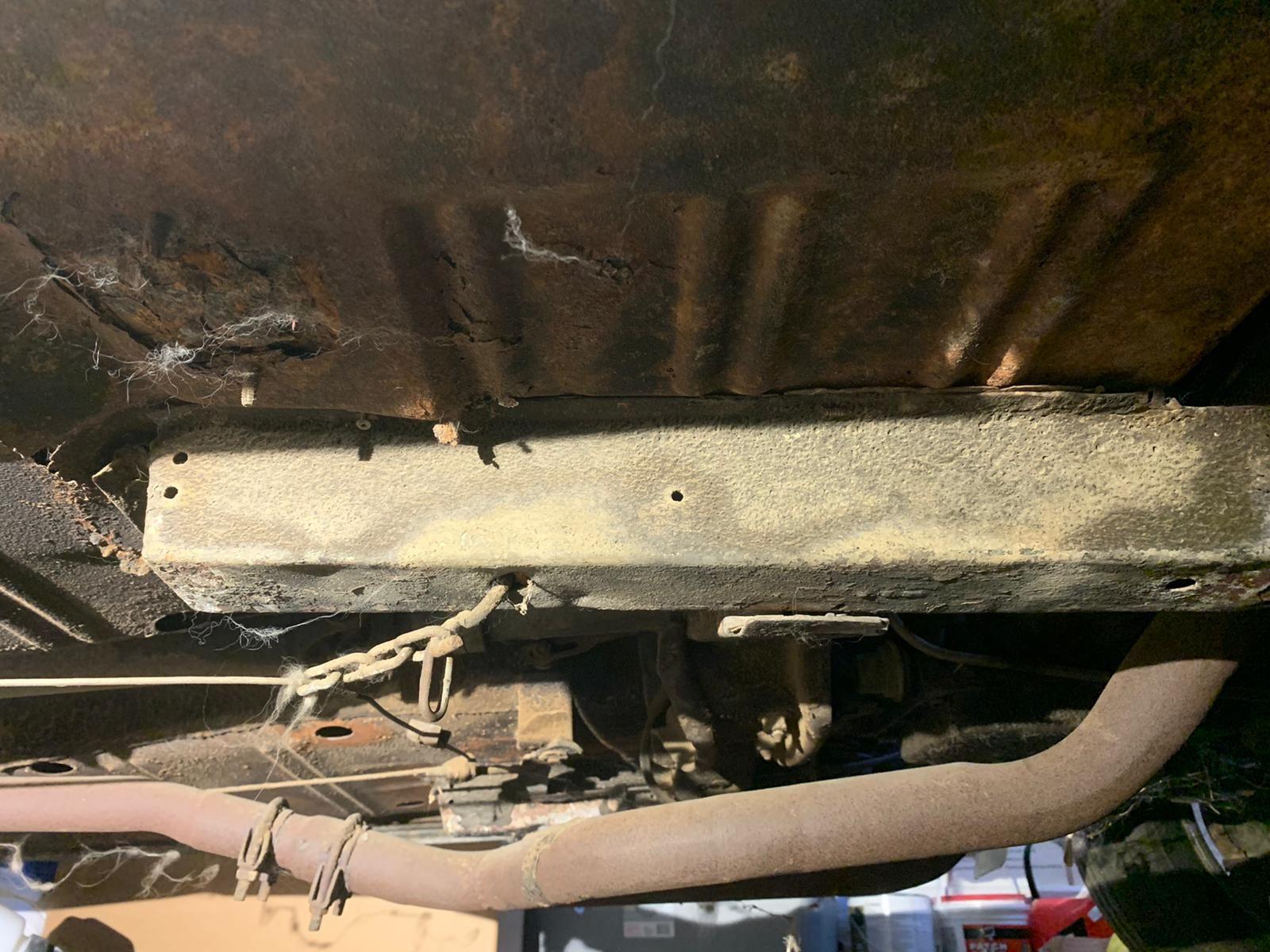

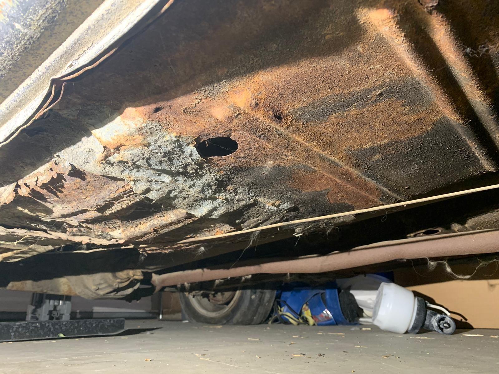

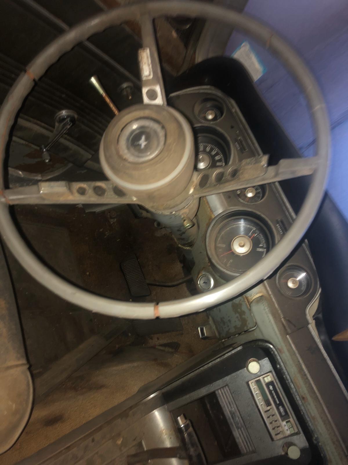

I don't have too much info on contacts, but see a few things to point out. First you have a coup and Eleanors are fastbacks. Other than that the floor pans look like they are sagging....rusted out. You do have a nice option in the console, the rest looks standard, steering wheel, seats, no ac, but all that can be changed in the resto.
Hope
you have a healthy budget. You can check into Mustang Plus, their inhouse name
parts seem to be a little better quality. Don't know if they would ship overseas.
Big project!!!

Its going to cost a ton I suspect you are aware of this I also suspect you have a ton to spend. If Ive guessed right then I would recommend not spending any money on that car as it is a coup and a very rough one at that. something like you see in that picture is likley near 75 to 100k USD. It would cost nearly the same for the coup but the end value would be much less with the coup.

Floor Panels I can say yes they will have to be completely replaced, I was thinking to get ready floor panels. (https://www.cjponyparts.com/full-flo...5-1968/p/FLP8/ )
