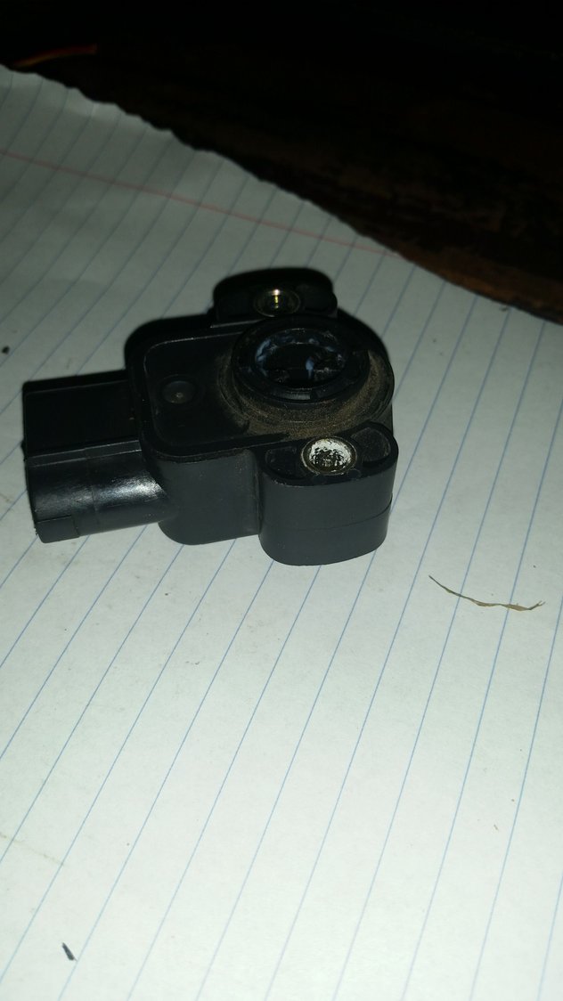

I'm leaning towards it being the TPS. The new one in ordered from Ebay does not have a spring inside it. I have several other TPS for earlier model Mustangs and out of curiosity I opened one and yes it has a spring. Attached is the before / after of the TPS.
