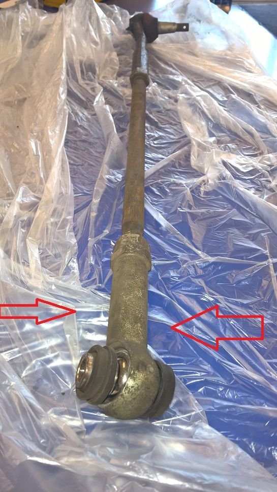

Hello Members,
My 03 Mach 1 was making thumping noise in back when I went over bumps
so I took it to the neighborhood repair shop to check it out, they told me
that the suspension on my Mach was changed to an independent suspension and that the problem was a worn out toe link,
well we have not been able to find the part because its an after market
toe link.
I hope the members here can give me some suggestions on finding the
part I need for my Mach cause the thumping noise is driving me nuts here are a couple of pics of the part... hope this helps.
Thanks in advance.... AL.

use this>>>>>>>>>>>>>>https://lmr.com/item/MM-IRSTR2/adjus...FYk6gQodqoAKSQ
you will have to change both of them but this will fit in place and with an alignment you will be good to go. FYI when looking for parts for the rear of your car search for parts for a 2003 mustang cobra, they came stock with rear independent suspension, and is the donor for swaps like what was done to your mach

Any chance the 99/01 Cobra IRS is a little different? Juat curious if the IRS has a number stamped to indicate which year exactly it is or if (doubtful) its from another model.

i dont think it matters as most of the parts listed fit 99-04. they should all be the same
