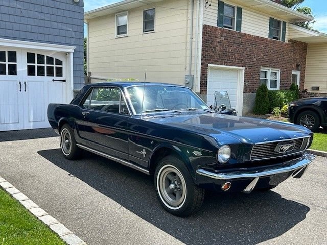

I just came to own a 1966 Coupe. It is 100% original with 45k miles. Was my uncles car. He is the original owner and the car had been in the garage for almost 60 years. It is in showroom condition. He Did some engine work. car is spotless. Came with a few trophy's from shows he took it to. I think the gas in it must be very old and the heater core has a leak. Car has not been driven on many years. I believe the gas is very old so I has to change that out. Any suggestions on type of gas?? Any other comments or suggestions welcome. Thanks in advance

Sweet looking car. I still wouldn't run 100 Octane however. Higher octane isn't necessarily the answer and will actually hamper performance and economy if the engine isn't really built for it. That's a race fuel meant for really high compression and performance at high RPM. Your car looks more like a really cool street machine with streetable high performance in mind.
