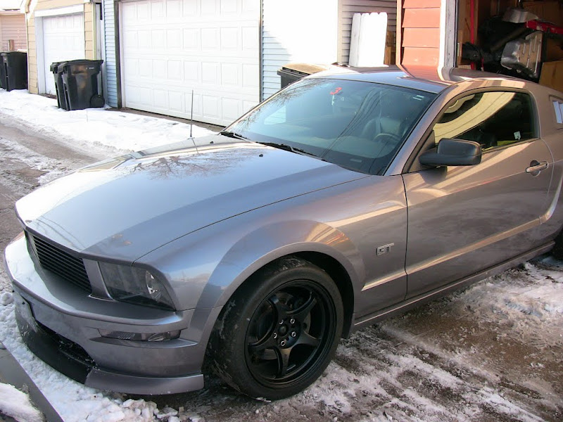

Ok, I've got more info to pass along, but I wanted to show 14901490 what I was talking about. The wheel here is almost identical to what you're running. This is an 18x9.5" wheel with +35mm offset. My car is lowered 1" and I run approx. -2 deg. camber. This is a shot from the front with a weighted line taped on the fender.
(I get to play w/new found tech-knowledge!)
Ok, the distance from the line to the tire is 1/8" and the edge of this particular wheel sits another 3/16" in from the outermost edge of the tire. So if you run a similar set up, but spaced out another 22 mm (25 mm spacer, minus the 3 mm difference in offset), you're looking at a tire that is sitting a good 7/8" outside of the fender. Your wheel will be 11/16" outside the fender. There's a lot of ways to tweak stuff, but this seems like a bit of a pill to swallow.

Ok, so a few bits of information.
The above wheels are 5Zigens FN0R1-C 18x9.5", +35mm offset, 23 lbs.
The FN0R1-C were once produced under the 5Zigen wheel line, but are now produced under the ProRacer lineup (still same company, even same website). They are most definitely not out of production, and they're called FN01R-C Hot Version. Ok, whatever. Anyway, if you're interested, they're currently easily obtainable for $1,050 (incl. tax and/or shipping). Folks might be trying to sell off the last of their stock on the older version, but specs (incl. weight) are all the same. The only discernible difference I could spot is that the older ones have the 5Zigen logo painted on or as sticker. The new ones have it cast into the wheel spoke. The ones in the pics above are the newer version.
Outer fender clearance is explained above.
Strut clearance wearing 275/35 Hoosier R6 is a hair over 5/8", which should mean you can go with the exact same wheel/tire size with as much as +45 mm offset with no problems at all.
Brake clearance is HUGE!! Holy hell, these things swallow every 14" brake template I have with ease.
For a comparison, I weighed my 18" OEM wheel currently shod with 245/40 Toyo R1R, and it came in at 48 lbs. The tire spec is 25 lbs (they're fairly fresh), so that puts our 18x8.5" wheel at around 23 lbs. Not bad.
I'm still researching to see if the new Enkei PF01 wheels will clear the Stoptech 14" brakes. They're confirmed to clear the Brembos on the EVO X, so I'm hopeful they're good to go. If I get a definite yes, they're going to be at least one of the sets I get. I just wish I could get them in black (for the track set).

I like those 5zigens and the 35 offset looks perfect (to me). Weight is in performance/price range and the matte black would look good on my alloy car (my current steedas are gloss black with silver lip). I'd also save ~3lbs per wheel over my current setup. Thanks for the great pics philo. Another set of wheels to add to my consideration list...
