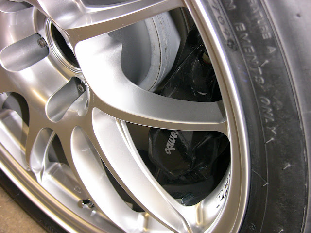

Sure, the FN01R-C wheels in that size clear all big brake kits. Those are the ones in the pics above.
The PF01's definitely work with the Stoptech calipers (14" rotors). I posted pics of it in another thread...how about this:
Clearance on the Brembo's is about the same as the Stoptech calipers. This isn't the best shot, but it shows the actual wheel on the car with the Stoptech's in place.

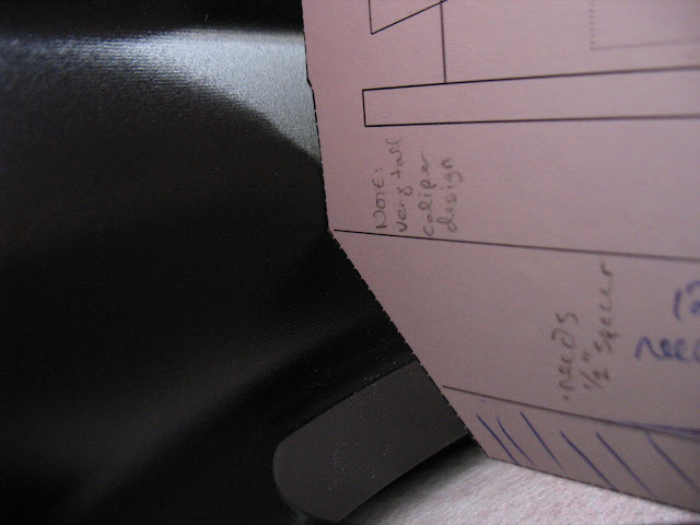

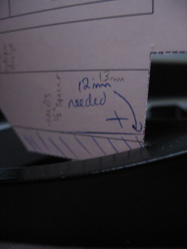

As for the RPF-1 wheels, I'd love to see pics! I had them in 18x9.5" and +45mm offset and they did not clear the Stoptech template; they were no where near clearing. I have a hard time imagining that even a +35mm offset would fit with this spoke design and in 9.5" width. Here's some shots of the interference:
At the spoke:
More troubling was that the hoop itself didn't clear. Note the contact made:
And would you believe that this gentle touch was only possible by pushing back on the template; the true interference was even greater. But if we have confirmation that they do fit with a 10" width and no spacers, I'd love to see it. I may be on the market for "rain wheels" etc... =)

Hey CC, just to be clear you weren't mistaken. The pics in this particular thread were of the FN01R-C's on my car before I put the Stoptech's on. They were loaned to me from a buddy of mine running Brembo's, so I knew they'd clear the brakes I had coming. I just wanted to get a look at them and see how they appealed to me. Of course, on his car (Brembo equipped), there's tons of clearance.
And yes, I too am loving the cost of these compared to other genuinely light wheels.
