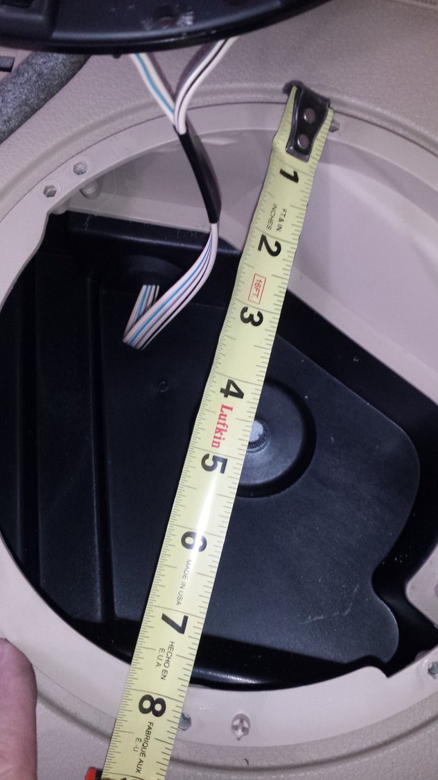

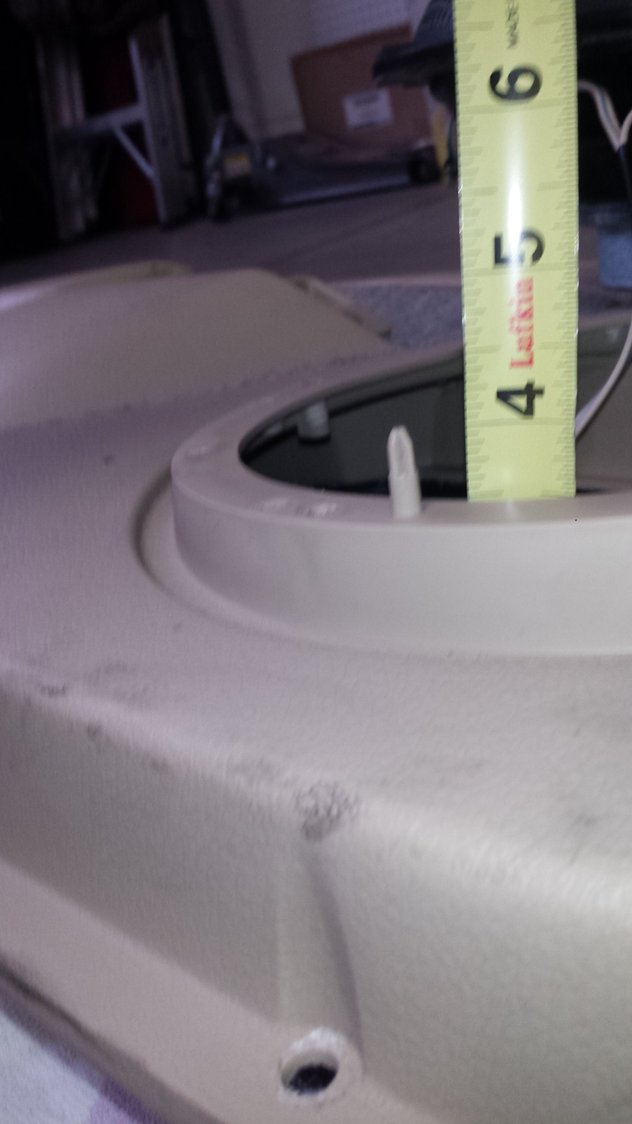

Here are some pics of the sub enclosure and what you have to work with. From everything I've read, the limiting factor hasn't been the depth of the speaker, or the cutout diameter, its been the diameter of the magnet. The RT Kicker has a 5" speaker diameter. I had a chance to open up one of the sub enclosures while I was working on other stuff this past weekend and I took some measurements. That shelf is about half way down the opening and is what gets most people hung up. Some have cut it off (stupid move since you have now compromised the enclosure) and others have used a heat gun and some 'gentle' persuasion to round it out a bit. When you look in the door where the sub enclosure fits, the opening does not need a shelf and the window doesn't go near it so, rounding it out would be my choice.
3.5 Inch top mounting depth at shallowest point (bottom of door)
Shelf in the upper right quadrant of opening in Drivers door. Passenger door would have it in upper left.
Nice 7.25-7.5 inch cutout diameter. Shelf sticks out about 2 to 2.5 inches from the edge
