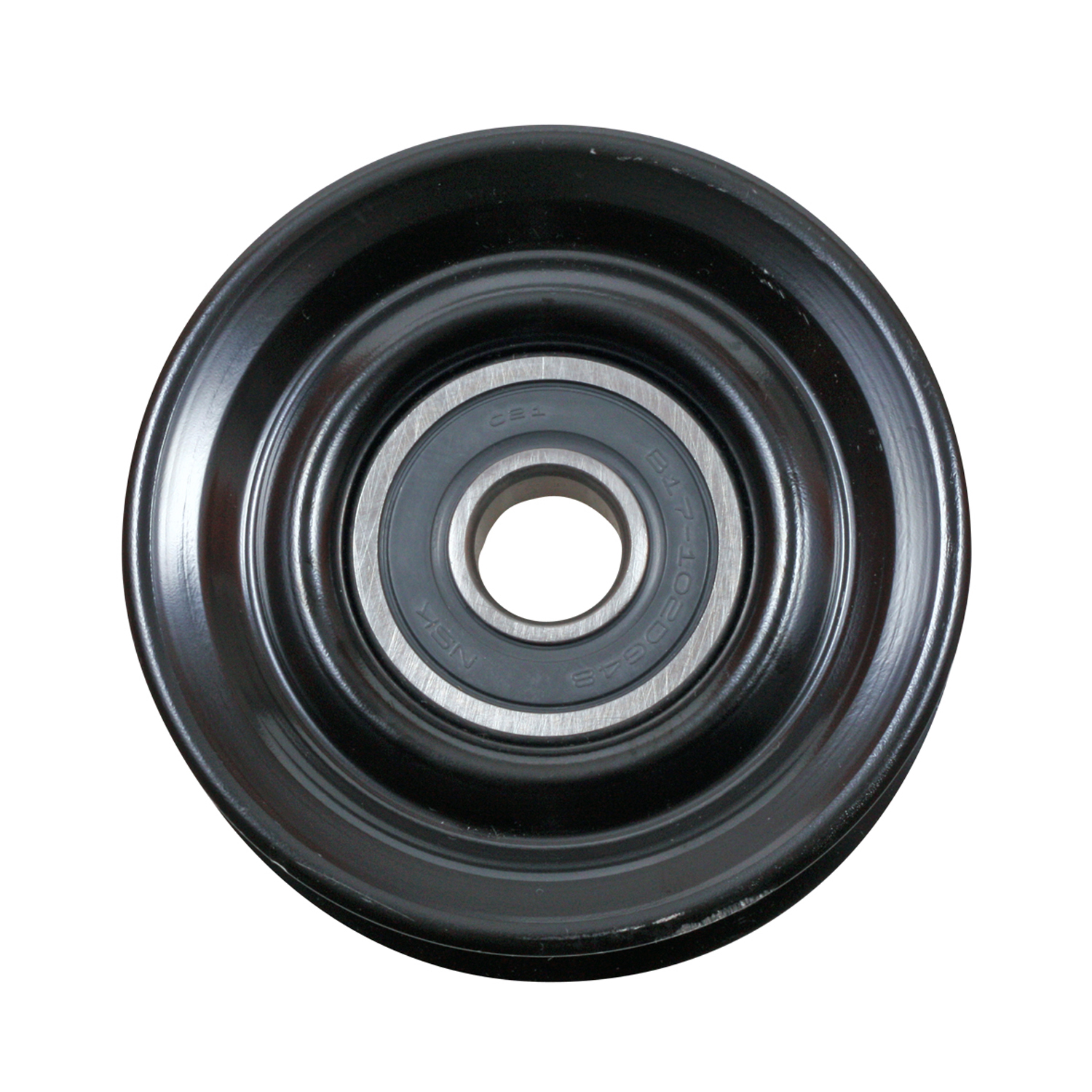

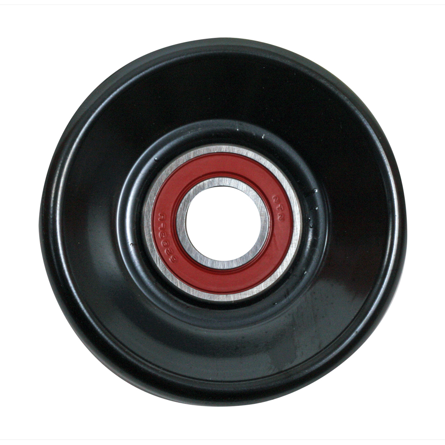

It didn't work. Mechanic listened into it, still believes it's the pulleys. Not sure which to get though. Goodyear is listening two different ones.
http://www.vindecipher.com/resources...ners/49123.jpg
and
http://www.vindecipher.com/resources...ners/49001.jpg
One is grooved and one is smooth, and I'm told there's supposed to be three on the car? Which do I need, and how many?

Depends on which one that's a replacement for, 4 total(with tensioner included), 1 should be grooved I think. 6 Rib. So, for what I think you're trying to replace, need 1 6 rib grooved, and 2 of the smooth ones. Assuming those are the right ones.
The part #'s differ, so I assume differing sizes depending on which...
http://iihs.net/fsm/?dir=203&viewfile=Front%20End%20Accessory%20Drive% 20(FEAD)%20-%20Exploded%20View.pdf (page 2) only 2 of the idler pulley part #'s are the same...
and http://iihs.net/fsm/?dir=201&viewfil...ry%20Drive.pdf
