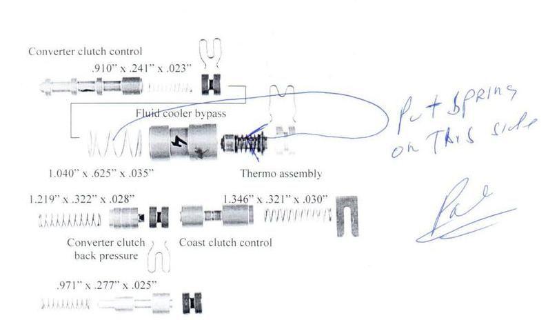

There is a cold start VALVE you can lock it open:
The modification sent by Pat Barret of Level 10 Performance Transmission:
  • Disassemble cold-start valve on the bench.
  • Relocate the big spring to the other side as hown for full trans-cooler flow.
This valve restricts flow, but does not block flow, unless it's bad.
It was designed for extreme cold weather startups, like 20-30 below zero.
This cold-start valve failure is one of the most popular failing points of the 5R55W/S
According to Pat Barrett of Level 10 Performance Transmission, in an article from Muscle Mustang & Fast Fords,
he said it was best to just leave it open.

That is the thermostatic valve. It opens/closes based on temp (no other input). Its function is a cold-start valve to help warm up the fluid faster in cold weather. I suppose thermostatic valve implied that it regulates the temperature which it does not. Anyways, Yes, that is the valve and that is the easy fix to make it stay open regardless of temp.
