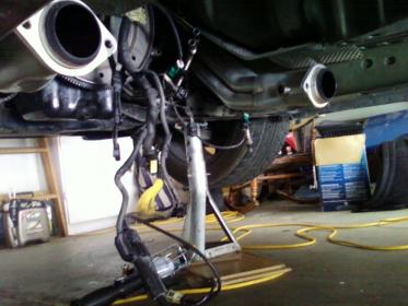

Just an update on my build, i'm still waiting on the torque converter and the shifter, hopefully should get those sometime next week, or the week after. Sadly looks like i'll be away on business for awhile so when I get back I should be able to get the mustang back together and post some pictures of how the install went. I do have to say, I just got the deep tranny pan from brenspeed and this thing looks sick, very well made.

Well finally got it finished took about three days of working after getting home from work to finish it but all in all it wasn't to bad. The hardest part was probably getting the dipstick to mount correctly. I'll try to get pictures up later. One problem I did have, was that a hole on the torque converter was stripped and I had to retap it but all ended well. Make sure not to over fill the deep pan it will puke fluid everywhere wish I has paid closer attention at first but no harm done. A transmission jack is a major help, I only need help from another person to get the transmission on the jack haha that thing is heavy.
As far as some tips go, just take your time and don't try to skip any steps. There's a reason that it goes 1-10 and not 1, 6, 8, 10 haha

Ok guys sorry it has taken me so long to finally get these pictures up but to be honest i've been lazy haha i hope my story helps others. If you plan on racing make sure the car can handle it but that's part of modding.
