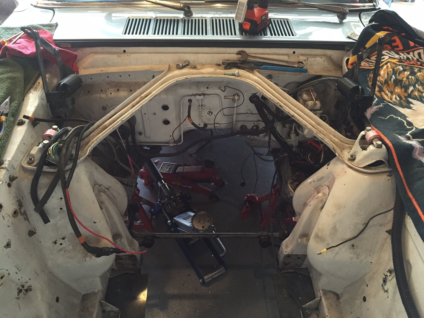

Well, after six years of electric driving, I'm going to pull everything out and start over.
The car worked as a daily driver. I drove it nearly every day, but it never performed as well as I'd hoped.

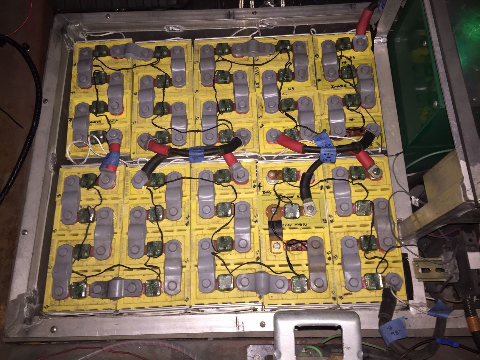

The culprits were both the motor and the batteries. The motor came off a bus, so I thought it would move a little Mustang pretty well. Although it had decent torque (200 ft lbs), it only had about 80 HP. I guess that's why you never see a bus drag racing....
The batteries were also a source of weakness. The pack voltage dropped significantly under heavy load (like when trying to accelerate) and that further limited my available HP. The batteries were supposed to last about 10 years, but quality control wasn't great on these old Chinese cells (it's gotten better) and the pack is only as strong as its weakest cell. As it got near the end of its lifespan, cells were beginning to drop like flies.
So I'm pulling all the old components out and putting new ones in. Electric car technology has improved dramatically since 2008, when I first put the EStang together, so I should see a big improvement in performance.
Here's the "before" pics:
The front...
...and the back
Here's all the stuff we pulled out:
To be donated to a nearby tech college.
Here's the "after" pics:
The front....
...and the back
And here's the car, riding high:
