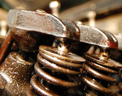

There's your problem. The 351W never had the flat rockers, but someone has installed them on your engine.
A flat rocker on a rail valve would look like this, and have basically nothing holding it in place on the tip-
The rockers you need have little rails on each side, preventing the tip from shifting.
As long as you have the correct rail-type valves, all you need is a set of rail rockers and your problems are over.
