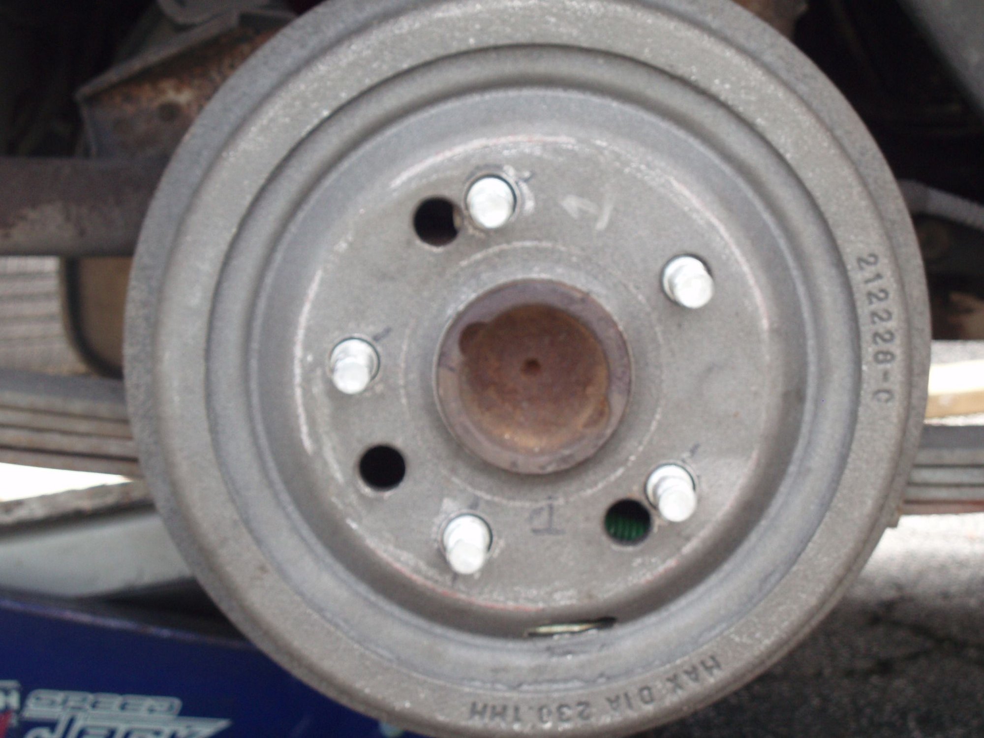

i also did a five lug conversion on all four corners, more wheel and tire options than 4 lug. 67 was easy, i6 spindles are the same as v8, found complete front v8 drums set up on eBay $150 and done, five lug conversion and brake upgrade all at the same time. Rear axels were re-drilled for five lug pattern by Modern Trany, they can make you a new drive shaft for the tranny swap too. I also did a fan shroud, had to make it from universal shroud , came out great! Electric fan might eliminate that, but I still think a full radiator size is better than fan electric fan size..all things considered. Add some tinted windows, a little insulation, oh yea, rebuild your factory heater before you put the under dash air in!!
