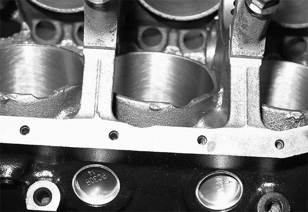

Old Aug 15, 2023 | 12:57 PM
Mark O'Neal's Avatar
Mark O'Neal
Joined: Aug 2009
Posts: 86
From: CA
This is it for the 347.
