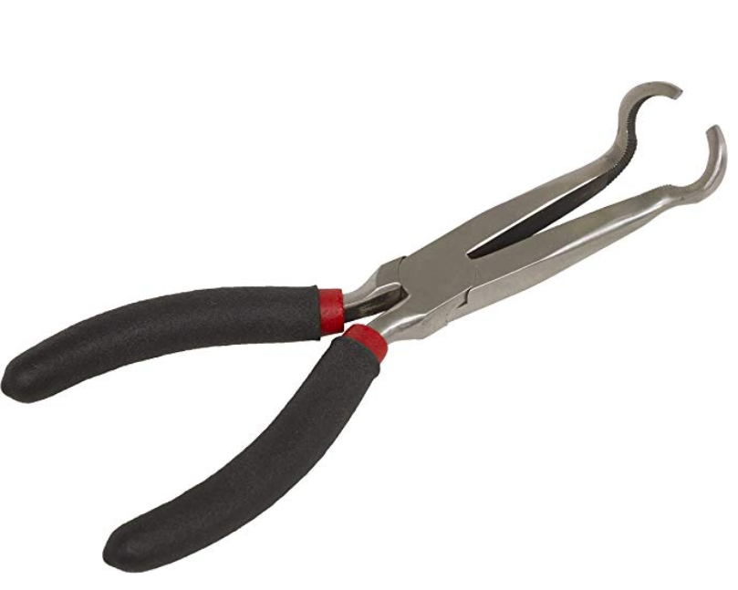

Thanks a million. Would a pair of long needle nose pliers work instead? Or something like the pic below?

You can try but the tools were made for a reason. If the carbon on the spark plug tip is really thick, pliers won't get the pieces out. It cements the spark plug body to the head.
You can always buy the tool, use it, then resell it for what you paid for on e-bay or craigslist. You can also check if your local auto parts store has one they can rent to you.
