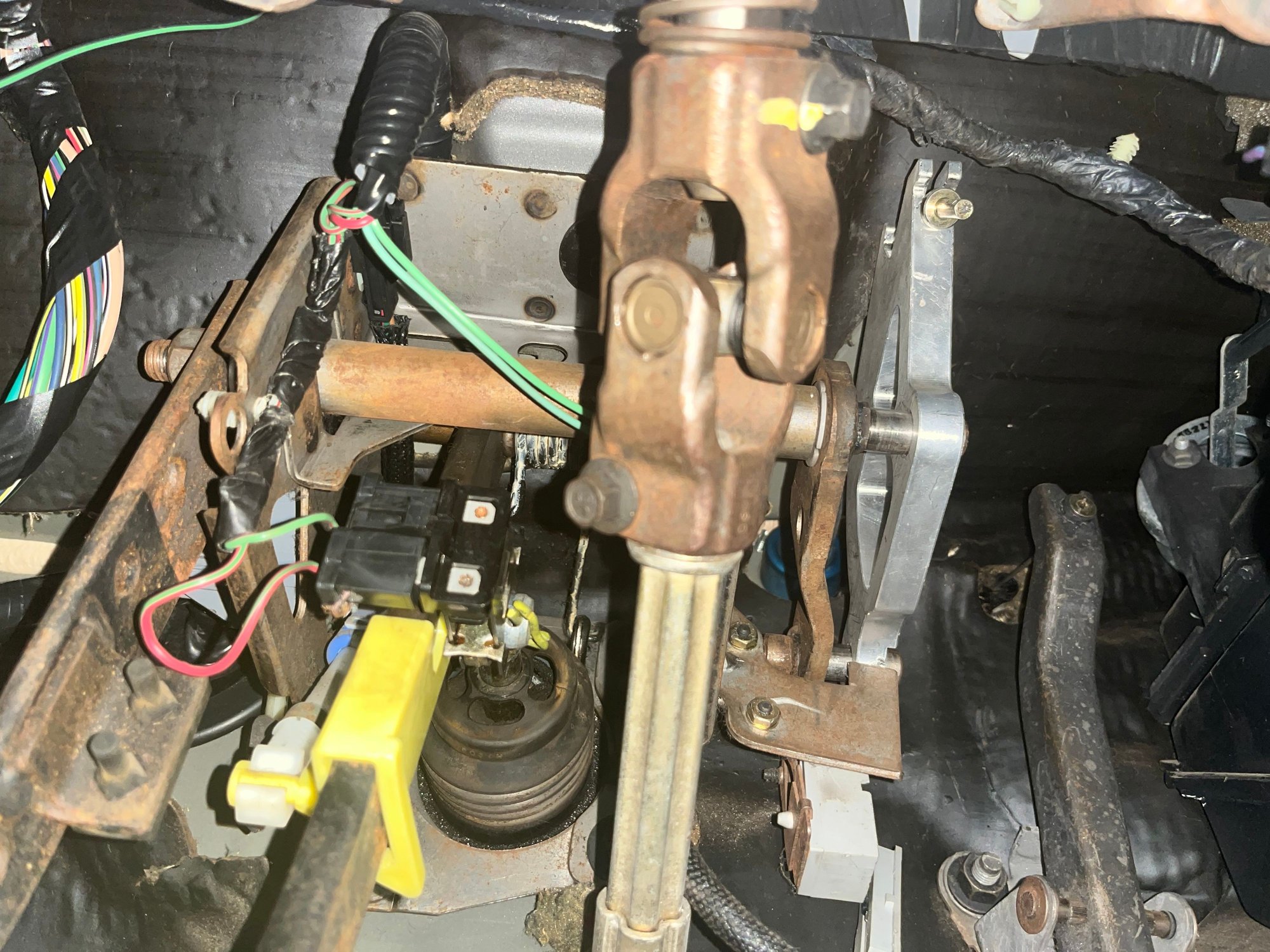

Default 2000 3.8 v6 5 speed no clutch
I just bought a 2000 v6 5 speed for $500, was told the trans was blown and saw **** ton of tranny fluid leaking, initially i with the car off, it shifts into all gears fairly easy, but running it will not go into gear, looks like the quadrant and cable was changed, but I’ve noticed the return spring and cotter pins to hold quadrant were missing, I have videos and pictures to help see a bit of what’s going on, just looking for help as to what should be replaced

Showing clutch
