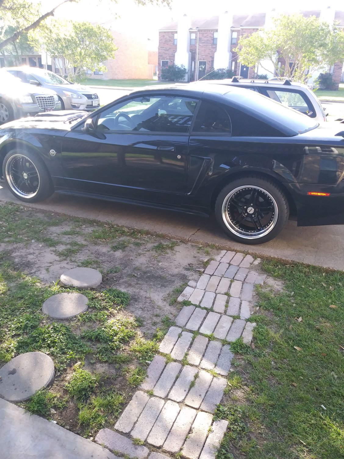

Hello everyone, I am new to the forums I need help with a question I have about wheel spacers and will I need them on my 04 mustang? Right now I am running on stock rims which are 215/60/16 all around and I am going to put 265/35/18 for the front and 285/35/18 for the rear so will I need spacers or will they fit without?

These wheels will fit, no spacers needed.
Go with taller/wider tire on the rear. On a 10" wheel, 285 is pretty narrow. 295/25 or 305/35.
