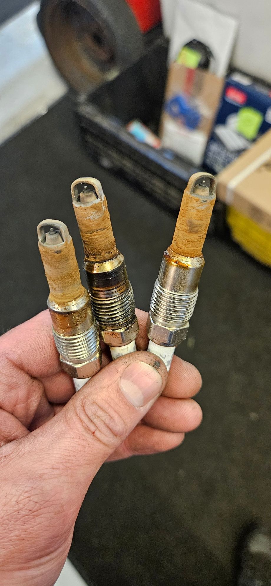

"p0316 Engine misfire detected on start up. P0689 PCM power relay sense circuit low.. There is history of misfires on cylinder #2 in the data. Removed spark plug and found it worn. Recommend replacing plugs and coils."
6) I ask them to pull a second plug - they pull 2 others - they all look old and corroded.
7) I tell them to replace all of them + coils. $1200

It seems to me they completely disregarded what I told them about the engine light coming on and pulling P2004.
It seems way more likely to me that an entire bank's butterfly flaps not functioning well would cause this rough running. But I'm no mechanic.

I would pull the intake off myself and check the charge motion flaps and see if there is a lot of build-up there preventing normal operation. They tend to sometimes get stuck. Before the supercharger install, I did that and removed those plates and put the deletes on and as I had a Brenspeed tune, I had them adjust my tune for that and it ran just fine. Mind you I had no problems prior.
