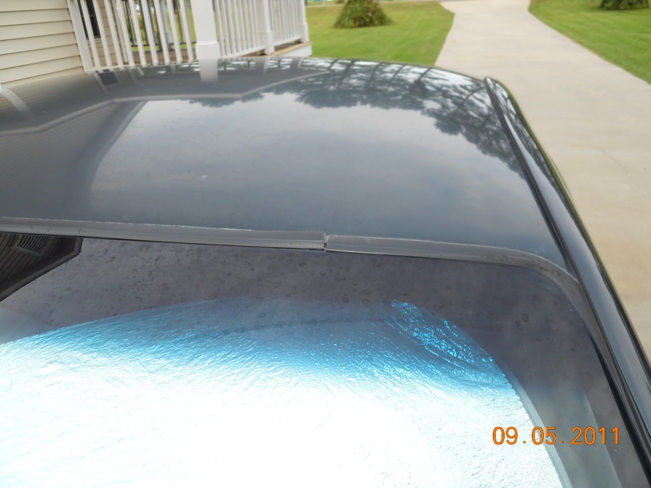

But, it did not have a definitive answer & the Service Manual is a bit ambiguous too ... the question is, do you have to remove the windshield to replace the rubber trim (Ford P/N F4ZZ-6303144-BAM) that is around the windshield?
As seen in the pic below, mine has decided to split for some reason and is looking pretty tacky.

When I had a chip filled at Safelite Auto Glass, the tech there told me that these mustangs come with the weatherstrip already attached to the window. Thus, new weatherstrip = new glass. If you have good insurance they may cover the cost of a new one.........I know USAA will for me.

read cliffyk's response. now i realize this is for the bottom of the glass, but may apply to your situation as well. using some rubber cement or a rubber-friendly sealant where the crack is may be a viable solution for the repair work involved.

First hint, if you watch closely, is you'll see the new windshield with the rubber molding already attached. So I contacted Safelite and got this response:
the moldings would come attached to the new windshield
So the answer is (for anyone else who searches for this) ... you can purchase & install replacement molding, but'll you'll have to remove the windshield to do so.
