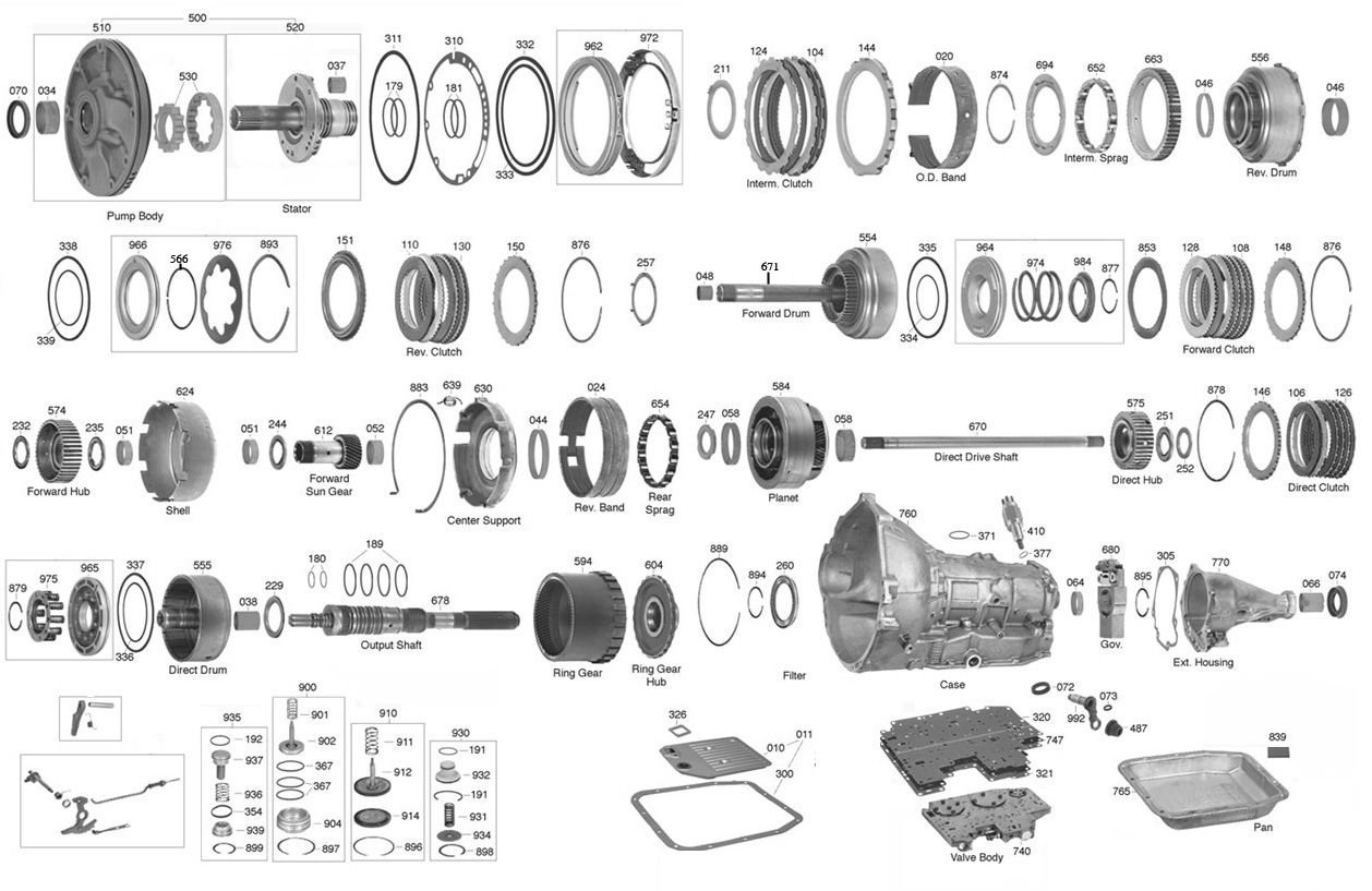

Hey guys, haven't been on this forum for ages but lookin for some help from the fox body guys that know about AOD Transmissions. I originally posted this question in 2021 and just put the car aside out of frustration and worked on my F100, Now I'm trying to get back on the Mustang. I put an AOD out of an... 87-ish Mustang into my '68 coupe and after topping off the fluid, adjusting the TV cable, checking for leaks etc, took it out for its first drive. It moved forward and back in the garage and I was stoked but on the test drive, the transmission refused to shift out of first gear. Revving high in first it just seems to want to hold in gear. When you let off the gas the hydraulic pressure is released as if it shifts, it doesn't engine brake like it stays in first. Then when you attempt to accelerate again, it's like its not in gear at all, the transmission just free revs. At this point it is out of first but not in second. Could be in high gear i suppose. If I put the trans in neutral, then back into drive, I have hydraulic pressure again and the trans grabs again but is again in first gear. The AOD has a B&M shift kit and Hughes 2500 stall converter, other than that, stock.
Could this be a symptom of a bad lip seal on the piston between the forward clutch and forward drum? I fought and fought that seal and was never convinced it was perfect. it's of course a total rebuild to replace that so trying to narrow down what to look for.
looking at the transpartsonline diagram, it is item 334 and 335 https://www.transpartsonline.com/TRA...sPartsType=AOD
