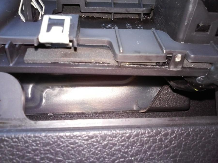

Is it the speaker cover you push on, or the enclosure?
It can be fixed with dynamat or form rubber strip...
My driver side window/lock center vibrated with the door subs. so, I
took it our and lined the under side of the switch housing with 1/8"
foam tape; solved. So, I did the passenger side just in case.
The Sub speaker grills come off, see if it stops when you remove the
grille(s). If it does, then line the under side of the grille(s) with foam
rubber tape. That will put more tension on the locking tabs, and stop
them from vibrating.
Here is what I did:
Both sides, no more rattle from bass.
