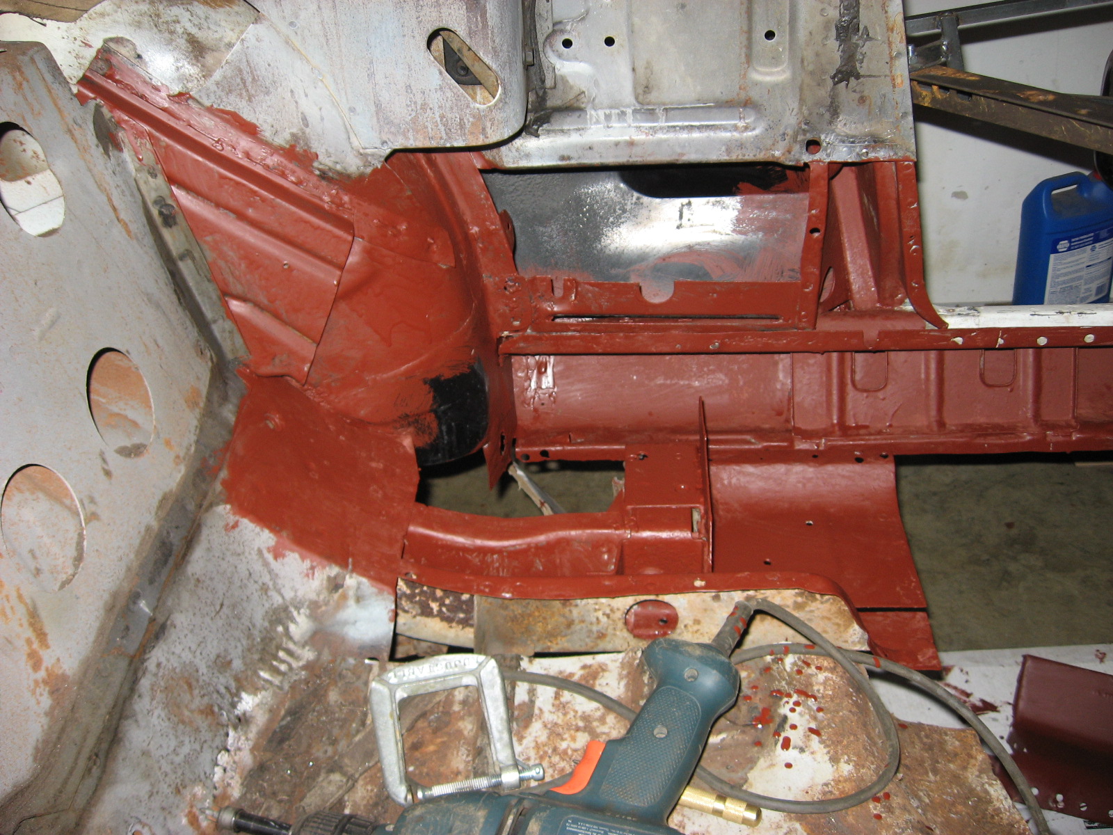

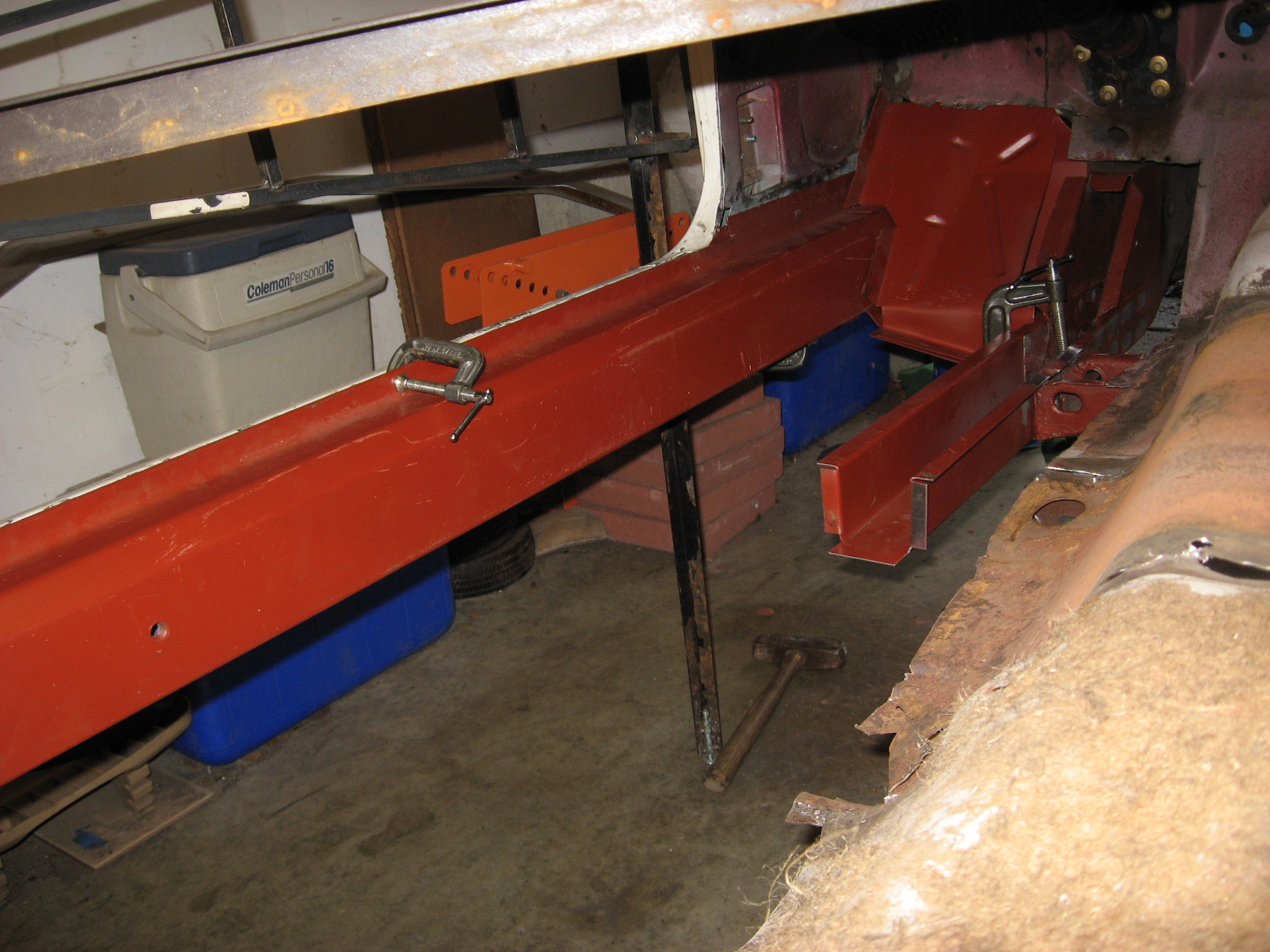

Couple pics of how I braced mine. I was doing a full inner outer. If you are doing just inner 2+2 is right you should brace door. I'd also put it on stands and make sure both sides are even. There is actually some dimensions you can refer to in shop manual (if you have one) that tells height key points shoulds be at. I took a lazer level and was able to get them lined up. Before I built the jig I was using trailer jacks instead of jackstands. Trailer jacks are easier to get exact height you need.

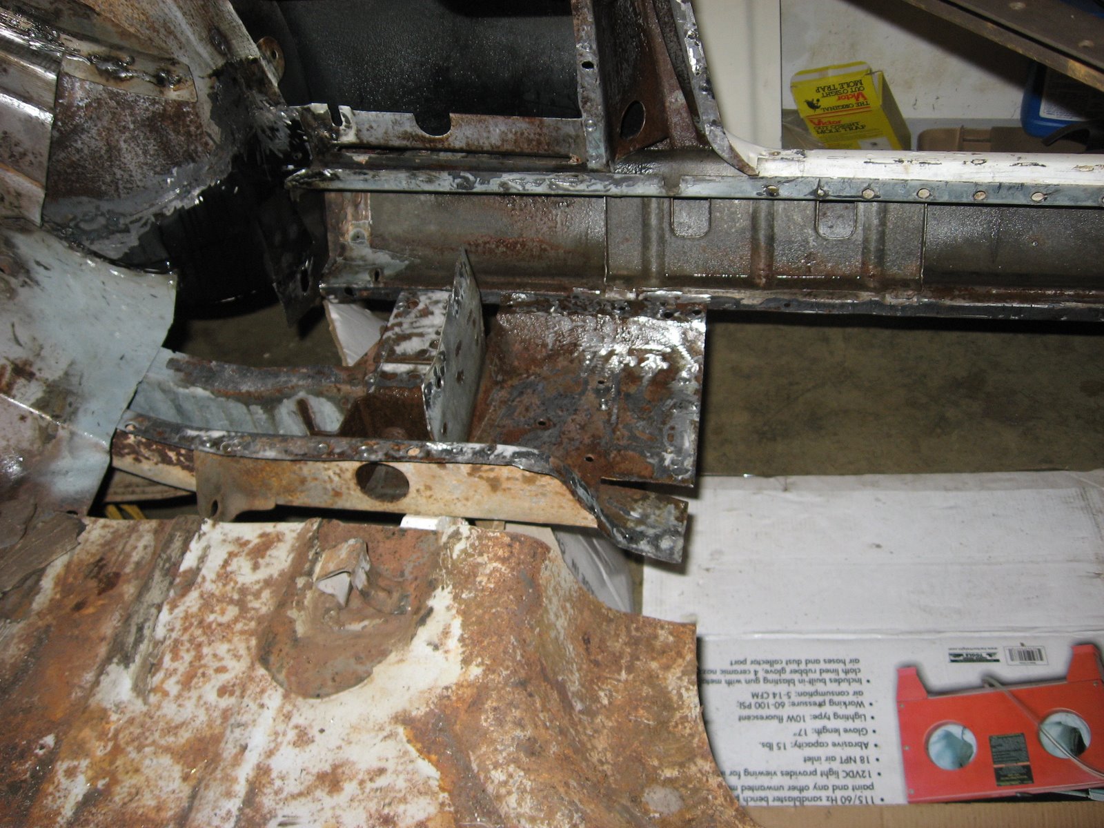

Old Apr 10, 2011 | 10:25 AM
  #40
jgemperline's Avatar
jgemperline
Joined: Aug 2008
Posts: 142
From: Colorado
I'm using a new tb and plan to separate it if needed. I'm still prepping the outer rocker. I used ospho and primer.
