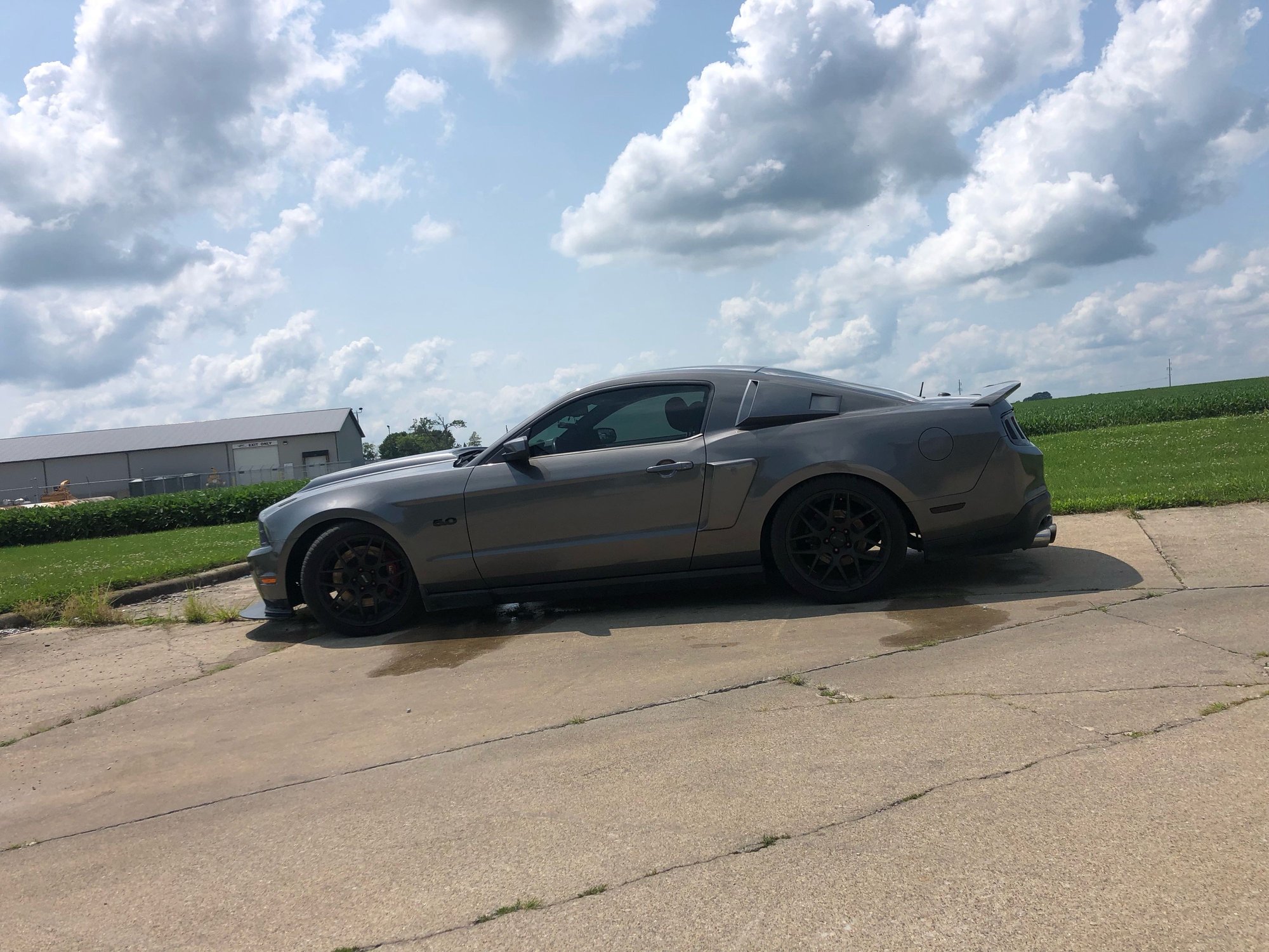

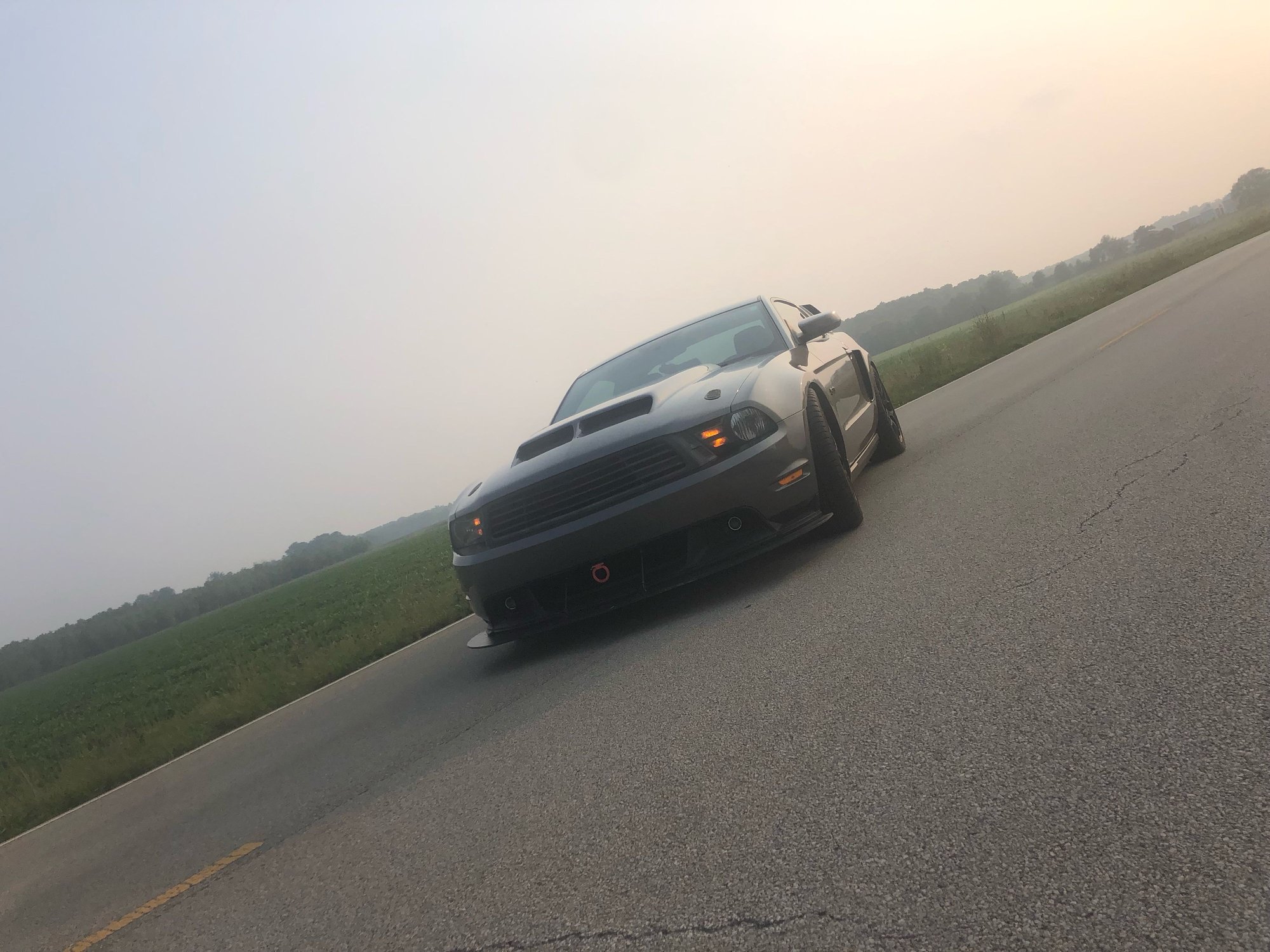

Here are a few pictures of the car so you can get an idea of the look:
