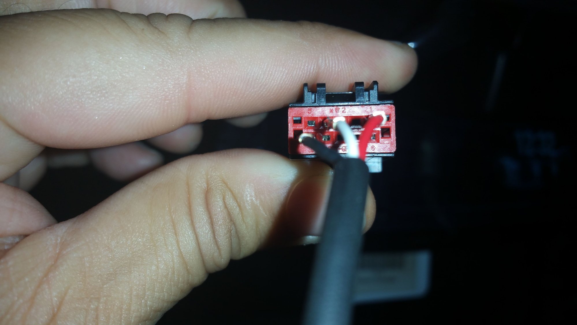

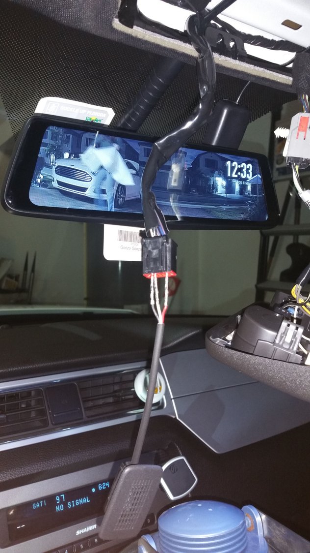

Hello,
I'm new to the forum and late to the thread, but sharing just in case anyone is having the same issue. For my 2012 Mustang (aka: Silver) I purchased the Auto-vox x1 pro touch screen rear view mirror with front and rear cameras and realized that by removing the original mirror, I was also removing my microphone so I needed a replacement.
I spoke with several Ford dealership reps and no one could help with the microphone questions I had. I did see several after market replacement microphones that you can splice in to the original harness that plugged into the OEM rear view mirror, but costing $100+. Nope. However, I found the instructions from those to be helpful to see how they tie their replacement mic to the specific three wires required (hot, ground and mic) on the existing harness in my car.
So, for $30. I decided to buy the F150 microphone that matched my interior headliner. If this microphone works with the F150 sync system then it should work for my stang... right?
When I received it, I realized the end of the part would not connect to the existing power harness. So, I broke off the plastic surrounding the wires and was left with three individual wires from the microphone (Red, Black, and White) and the best part was that they were each pinned. I crossed my fingers and I was able to find a diagram of the harness for my car which has ten pin openings. The top five, starting from the right to left are 1-5, the bottom right to left are 6-10. Slot 1 with a Blue wire is for power (12 volt), slot 4 with Yellow wire is for mic and slot 10 with Yellow/Black stripe is for ground. I took the F150 microphone and pinned the Red wire to slot 1, the White wire to Slot 4, and the Black wire to slot 10. I turned the car on and hit the voice button and commanded it to make a call and it worked.... I hope this helps future Mustang riders. I have attached photos...
